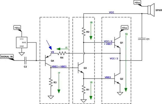

A 3rd BJT's \$V_\text{CE}\$ spans the voltage distance between the two bases. Increasing the base current of \$Q_3\$ increases its collector current, diverting current away from the base of \$Q_1\$ and towards the base of \$Q_2\$, causing \$Q_2\$ to sink more current and forcing \$Q_1\$ to source less current. If \$Q_2\$ is sinking more than \$Q_1\$ can source, the difference comes from the speaker. If \$Q_2\$ is sinking less than \$Q_1\$ is sourcing, then the difference is goes into the speaker. When \$Q_2\$ is sinking exactly what \$Q_1\$ is sourcing, then the speaker has no current.
Driving the Output Stage
We've got a behavioral concept for the class-A output stage, now. But a remaining problem is to work out how to control \$Q_3\$. We need some method that will observe the output signal, after dividing it down to size, with the input signal and to somehow automatically adjust the base of \$Q_3\$ in order to force them to compare equally to each other. We need a comparator of some kind.
It turns out that a single BJT can do this by comparing a signal at its base with a signal at its emitter. If the signals diverge away from each other, then the \$V_\text{BE}\$ increases and this causes the collector current to increase. If the signals converge, they decrease and pinch the \$V_\text{BE}\$ and this causes the collector current to decrease. So a BJT can compare two signals. If, that is, variations in its collector current can be made useful.
Here's how that might be made to work:
simulate this circuit
I've added a few boxes. One of them is a relatively simple AC divider. It divides down the output swing so that it can be compared with the input signal, 1:1. However, this divided AC signal will include a DC bias to it that also appears at \$Q_4\$'s emitter. So the other box is some kind of DC biasing needed to get the DC level at the base of PNP BJT \$Q_4\$ to within about one \$V_\text{BE}\$ of \$Q_4\$'s emitter DC bias. Other than that, all we need to do is to supply the input signal and the magic happens.
You may notice the arrows and some lettering I've added in red color. Let's see what happens if the voltage at A makes an undesired downward change. The downward change will be divided down by the AC divider-box, but will still be downward in direction when it appears at B. Since C is the input signal and didn't change, the downward change at B will pinch \$Q_4\$'s \$V_\text{BE}\$, causing its collector current to be reduced. This reduced collector current will source less current into \$R_3\$, reducing the voltage drop across \$R_3\$, so D makes a downward change causing the base voltage of \$Q_3\$ to also lower. That lowers E causing \$Q_2\$'s \$V_\text{BE}\$ to be likewise reduced, reducing its collector current. This reduction of \$Q_2\$'s collector current means its collector voltage will rise a little (F), which acts to counter the original change at A (which is the same node.)
So this control-loop does work to counteract undesired changes (such as the Early Effect in \$Q_2\$) and to bring the output under control as it continually compares the output with the signal input. It also acts to establish the desired quiescent DC operating point, if everything is designed right.
Establishing the DC Quiescent Point
The following diagram doesn't include the AC divider circuitry as it is AC-related. But it does now introduce \$R_4\$, which is needed for DC biasing:
In the above diagram, we want to set \$I_Q\$ such that it is about 10-20% above the peak load (speaker) compliance current. For example, to achieve \$1\:\text{W}\$ with an \$8\:\Omega\$ speaker, the peak speaker current would be \$\frac12\:\text{A}\$. Then \$I_Q= 550\:\text{mA}\$ might be satisfactory. Keep in mind that if \$V_\text{CC}=12\:\text{V}\$ then already this means about \$550\:\text{mA}\cdot 12\:\text{V}=6.6\:\text{W}\$ of quiescent power, without considering any of the rest of the circuit. All that just to deliver \$1\:\text{W}\$ into \$8\:\Omega\$! So don't be excessive.
Once you know \$I_Q\$, the datasheet can be consulted to estimate the worst case value of \$\beta_1=\beta_2\$ for the power NPN BJTs. Because of the active behavior of \$Q_3\$, \$R_1\$ doesn't need to be stiff. But I think it should be designed to carry at least 15% of \$\frac{I_Q}{\beta_1}\$, though I will often go for 20%. So, \$I_S \ge 15\%\cdot \frac{I_Q}{\beta_1}\$. With that, then \$I_B=\frac{I_Q}{\beta_1}+I_S\$. (\$I_B\$ is the current in "current source" \$R_2\$.) \$R_1\$ and \$R_2\$ are now determined.
At this point, \$Q_3\$ can be selected and its worst case \$\beta_3\$ determined from the datasheet (over its collector current range.) Here, \$R_3\$ does need to be stiff with respect to \$Q_3\$'s worst case base current. So \$I_T \ge 10\cdot \frac{I_B}{\beta_3}\$ and \$R_3\$ is now determined.
The value for \$V_X\$ should be high enough so that \$Q_4\$ is always in active mode. The value of \$V_X\$ determines the quiescent voltage for both the base and emitter of \$Q_4\$. The base voltage relates directly to the input's DC biasing network and its emitter voltage determines the magnitude of \$R_4\$, which will shortly also be a part of the AC divider network. I usually like to see \$V_\text{CE}\approx 4\:\text{V}\$, where possible. But there are several considerations here. Suffice it that it isn't critical. If you can't think of anything else to do, then compute the voltage difference between the base of \$Q_3\$ and \$\frac12 V_\text{CC}\$ and divide it in half, with half going to \$V_\text{CE}\$ and half going to \$R_4\$. I'll leave detailed considerations for another time. I'll continue to expand the following discussion, as time permits.
Beginning Topology
The following will be based upon what I've already written up here. In particular, I'm selecting the class-A approach that is the main thrust at that link. (The following ignores some of the development in the prior section.)
Note that I'm leaving in place the input biasing network and its values. I'm not even going to waste time discussing them. (See the link above, for more.) Instead, I'll focus on the rest of it -- starting at the output side and working backwards, from right side towards left side.

\$Q_1\$ and \$Q_2\$ will have to pass at least \$I_o\$. But to stay into class-A, it needs to be more. Because active devices aren't specified to tight tolerances (and especially the cheap stuff I buy), we should design for 20% more: \$1.2\:\text{A}\$. As a hobbyist, I can say this should provide enough margin. ;)

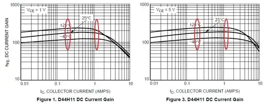

With this current compliance in hand, it's a good idea to select a BJT. I happen to have some (and a model) of the D44H11. It's cheap. Here's a quick snapshot from its datasheet:
I've circled the places where the minimum and maximum expected collector currents will be at. From this, it's clear the device has a fairly even response over the range we care about.
Now, from the table below we can estimate a reasonable \$\beta\$ in this design situation:
  • Power BJT: \$\beta=60\$
Combining this with the peak collector currents of \$1.2\:\text{A}\$, we find the peak base current of \$20\:\text{mA}\$. We'll need at least that much to be available through \$R_2\$. So let's add another 25% to that, so that \$I_{R_2}=25\:\text{mA}\$.
Roughly speaking, \$C_1\$ will have about \$\frac12 V_\text{CC}\$ across it (the capacitor is doing double-duty, acting as a bootstrap as well as DC-blocking.) The base-emitter junction of \$Q_1\$ will have a relatively "fixed" \$V_\text{BE}\$. So this means that \$R_2\$ will have a relatively fixed voltage across it, allowing it to operate much like a current source. Not perfect. But "good enough." And it will have about \$\frac12 V_\text{CC}-V_\text{BE}\$ across it. Since we know the current (prior paragraph) and know the voltage across it, we can compute:
  • \$R_2=\frac{\frac12 12\:\text{V}-800\:\text{mV}}{25\:\text{mA}}=208\:\Omega\$
    \$R_2=220\:\Omega\$
Note I set it to a little bit higher (for about \$24\:\text{mA}\$, instead.) I could have chosen \$R_2=180\:\Omega\$ but we are already using the smallest \$\beta\$ so it's already a conservative design. I'm comfortable loosening up a bit on the current and using the slightly larger-than-computed value, instead.
While \$R_2\$ may be close enough to a current source, that current has to go somewhere. That's \$Q_1\$'s base plus the remaining going through \$Q_3\$ and into either \$Q_2\$'s base or else via \$R_1\$ to ground. Those are the only options. Since \$Q_2\$'s \$V_\text{BE}\$ doesn't change all that much, we can set \$R_1\$ to pick up the excess we added, earlier (the extra \$24\:\text{mA}-20\:\text{mA}=4\:\text{mA}\$):
  • \$R_1=\frac{800\:\text{mV}}{4\:\text{mA}}=200\:\Omega\$
    \$R_1=180\:\Omega\$
Here, I set \$R_1\$ to soak up a little more than computed because, again, we used a conservative \$\beta\$ for the D44H11.
Keep in mind this is a cheap, wasteful, class-A amplifier. If there's no input signal, this amplifier is going to drive both \$Q_1\$ and \$Q_2\$ to source/sink pretty much all of the current that the speaker isn't getting. In short -- a lot. You can expect to see something on the order of about \$\frac12 V_\text{CC}\$ across each one, both running on about \$1\:\text{A}\$ of collector current. So there will be perhaps \$6\:\text{W}\$ each and that is hot. So \$Q_1\$ and \$Q_2\$ will need heat sinks.
\$C_1\$ should be big, too. You can work out the size from the lowest frequency you want to support. But for now, I'm just going to pick a large value that probably isn't large enough, but perhaps "adequate." If you can afford to do more, do it.
So far, we've got the following:
We now need enough base drive to run \$Q_3\$. This is supplied via \$Q_4\$ (which performs several functions at once -- see the link at the outset for some added details.) Since \$Q_3\$ can be a small-signal BJT, it's \$\beta\$ can be figured to be \$\beta\ge 100\$. (Still conservative, as it is likely higher than that.) So \$Q_3\$'s base current will be \$\le 200\:\mu\text{A}\$. I'd like \$R_5\$ to be stiff compared to this, so perhaps about \$1\:\text{mA}\$ in it. Also, \$R_3\$ should carry a similar current and in this particular circumstance will probably be okay if it drops near the same voltage. So we can just set them to about the same value:
  • \$R_5=\frac{700\:\text{mV}+800\:\text{mV}}{1\:\text{mA}}=1.5\:\text{k}\Omega\$
    \$R_3=R_5=1.5\:\text{k}\Omega\$
I'm rushing through this, my apologies. \$C_5\$, given the currents involved, can be larger than a nominal \$100\:\text{pF}\$. I'd guess it could serve well at \$1\:\text{nF}\$. (I'm not going to go through the details of why, here. Just stick it in.) \$C_2\$ should be at least the value of \$C_3\$, though more would be okay. Finally, \$R_4\$ needs to be the value of \$R_3\$ divided by \$A_v\$. So:
  • \$C_2=10\:\mu\text{F}\$
  • \$C_5=1\:\text{nF}\$
  • \$R_3=1.5\:\text{k}\Omega\$
  • \$R_4=18\:\Omega\$
  • \$R_5=1.5\:\text{k}\Omega\$
Let's plug that into the schematic:
That's it.
Now, let's plug that into LTspice (with a bigger bootstrap capacitor for \$C_1\$):
Yeah. That's close enough. (LTspice says the gain is very close to 80.)
The efficiency is terrible. Try \$R_2=390\:\Omega\$, for example. But at some point, it will start to distort ... a lot. Back off, when that happens. (If you do increase \$R_2\$, then you may also want to increase \$R_1\$ a little, as well.) Adjusting \$R_2\$ to optimize the amplifier is commonly done. So feel free to increase the value of \$R_2\$ to improve efficiency.
