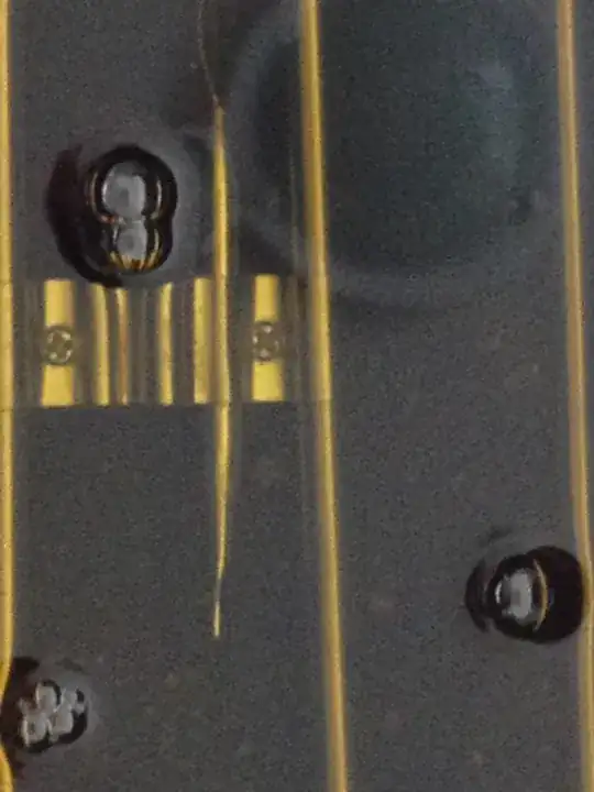

Hi, while I am tring to repair electronic circuit. I'm encountering this sponge. I wonder what is this sponge? and can I find out what it is used for. I often see this in sensitive circuits like in laptop board and near to cooling parts. Adheres on cooler materials

    EMC gasket. Search for laird tech. – winny Jun 02 '20 at 13:42
    It's basically a fancy version of a spring engineered to be more conductive or lighter (or in some instances simply fancier/trendier/fashionable) than a simple spring contact – slebetman Jun 03 '20 at 05:28

It is some kind of soft-open-cell foam, wrapped in conductive tape, to ensure a good grounding and shielding contact between pieces. The foam may or may not have large amounts of carbon particles in it to make the foam itself conductive.

As established this is an EMC foam gasket. It is commonly applied to lids of stainless steel enclosures and used for various grounding practices to improve ground connections or to provide a faraday cage for the blocking of electromagnetic fields.
