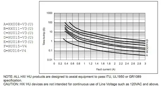

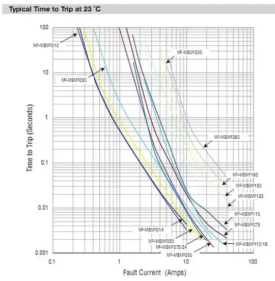

The quickest parts are the smallest SMD PTC's. < 0.1 sec < 1 watt dissipation. such as 1206 or 805. enter image description here
Above is response for a high current PTC sensor enter image description here
Above is for low current radial PTC starting with 80mA hold current at bottom for HX008

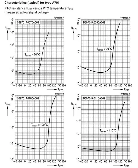

Above is for SMD 805 PTC showing resistance curve vs temp here being used as a thermal protection sensor rather than current limiter due to high cold resistance. (pref. thin track)
It should be clear that ALL PTC's are design to have dynamic impedance rapidly change at a similar temperature for same material. Some are standard 85'C others offer different threshold temps which affect your operating environmental range. See above variation)
