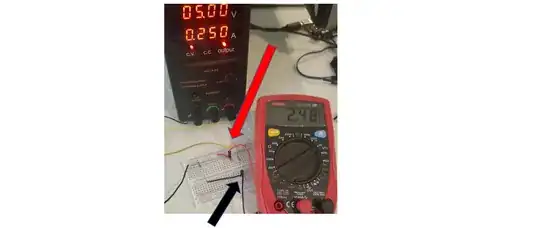

  5. To prove this is correct this is a circuit in real life: enter image description here (The yellow cable comes from the power supply with 5V. Then that is connected to the red cable. The red cable is connected to the 10 Ohms resistor. Then there is a blue cable connected to the other resistor. And finally that is connected to the black cable ground)
  6. If I then use a volt meter I can see the the voltage drop between the red wire and blue wire is 2.5 Volts: enter image description here

Figure 1. Feeding a short-circuit, feeding a reasonable load and feeding an open-circuit.
  • In the first case you have a short-circuit at the load end so the voltage is zero and no useful work is done. The current through the circuit will be \$ I = \frac V R = \frac 5 {20} = 0.25\ \text A \$.
  • In the second case you have a reasonable load of 980 Ω (just chosen to make the maths easy). The current through the circuit is \$ I = \frac V R = \frac 5 {1000} = 5\ \text {mA} \$. The voltage at the load will be 4.9 V and the total drop caused by the loop will be 0.1 V.
  • In the third case the circuit is open. No current is flowing so there is no voltage drop across the 10 Ω resistors. The voltage measured will be 5 V.
