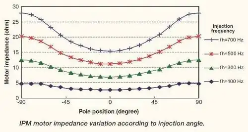

I skimmed through Google materials and there are two steps.
  1. First it measures the impedance of the coils by sending in current at a particular D-Q angle (I think). Then it changes the angle and compares the two impedances. In other words, it's measuring inductance or the strength of the two flux paths through the motor. This lets you get the rotor position, more or less.
enter image description here enter image description here https://www.controleng.com/articles/understanding-permanent-magnet-motors/
  1. But you can see from the graph above that it is symmetrical so there is an ambiguity which needs to be resolved. Unless perfectly centered, the presence of the PM field will bias the ferromagnetic domains in the iron core so it saturates in one direction earlier than the other. You can ramp up current in both directions and measure when it saturates to differentiate whether you are near a N or S pole. I'm not sure quite sure when this is done though.

  • regarding the ambiguity, isn't this resolved by using all 3 phases? – EmbeddedSoftwareEngineer Apr 16 '23 at 17:32
  • @EmbeddedSoftwareEngineer I never looked into it further so honestly I couldn't tell you. But my theory is that, assuming your approach works, it seems it would only work at zero speed. I think the intended usage for this method is not rotor sensing at startup but at low speed where you don't want to be de-energizing the phases involved with the rotation to energize phases not involved with the rotation. – DKNguyen Apr 16 '23 at 17:57
  • I am under the impression that this HFI is done on top of the regular motor phase currents, not standalone. – DKNguyen Apr 16 '23 at 18:04
