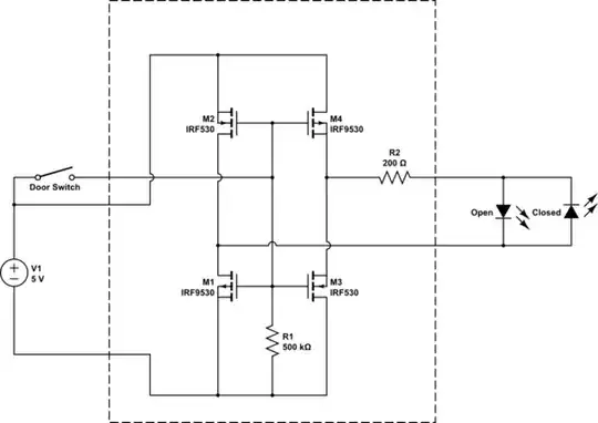

I duplicated my optoisolated circuit to have as input the index (Z) or the A signal from the encoder and wired the output of the optocoupler to another input of the cnc controller
I can'make it work on my circuit. As the mosfet is never turned on or off, so the output of the optocoupler never changes.
I even tried to replace the 2n7000 mosfet with a 2n2222 transistor and a 1k resistor between its base and the output of the encoder, still with no success.
If I wire the encoder directly to the lathe's tachometer it works. As I rotate it, the RPM (in the tachometer only) changes. So I suspect the tachometer inputs accepts different types of signals. But I can't pass it's signal to my cnc controller through my circuit.
My knowledge in electronics is basic, so, anyone could help me with my circuit? What am I doing wrong? Is the signal from the encoder different to be used with my optocoupler circuit? Should I add something to my circuit? Or change it? I’d like it to remain optoisolated...
My circuit is also attached.
Circuit diagram
I believe I would need to convert a TTL logic to an open collector logic? If it's true, is it simple to be done?

First of all according to the documentation https://docs.rs-online.com/e002/0900766b8145581a.pdf if we talk about piece of equipment from below picture, it has built in isolation on LPT port (including your INPUT1 and INPUT2). So you should treat them as driving LED cathode (comparable to your 4N25 isolator). Isolators, except isolation, impose noise into the circuit - multiplying them is not a recommended practice. enter image description here

  • Ok, I can modify the circuit. I was being extra careful, but boise can be a problem. But apart from that, the inputs sink 12V to GND, and the signal from the encoder varies at max 5V. So I couldn’t connect it directly. – Rodrigo May 24 '20 at 17:25
  • You are probably right. Data sheet is superficial about input levels. I think the good option is to use transistor to shift levels in similar manner as have you use it before. Please mind so called 'Logic-Level Gate Drive' compatibility if you will use MOS transistor. It will support higher drain currents with low TTL gate level drive. Transistor will impose phase shift, but seems it is acceptable for you. – gustawo2 May 24 '20 at 22:44
  • Tidy and quite fast solution for level translation without phase shift is presented here: [bi-directional-logic-level](https://circuitdigest.com/tutorial/bi-directional-logic-level-controller-using-mosfet) – gustawo2 May 24 '20 at 23:21
