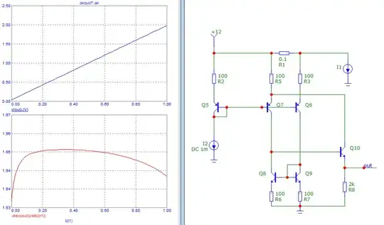

The last two circuits exploit the fact that the signal to be amplified is presented at a very low impedance on the low value shunt resistor, which means instead of using transistor bases as input we can use the emitters... because as you know the emitter is an output, but it is also a low impedance input !
This isn't really an opamp, rather it's a simple feedback circuit with a differential input pair Q6,Q7 biased via Q5. Current mirror Q8,Q9 directs the output current of the diff pair into Q10. It tries to keep voltage on Q6,Q7 emitters equal by injecting a small adjustment current via Q10 which changes Q7 emitter voltage to make it the same as Q6 emitter voltage. So this current is proportional to the voltage being measured on the shunt, and since this current is created via R8, we get out amplified output voltage on R8.
Again, don't expect miracles wrt accuracy or offset voltage, but it's a much simpler version of the first schematic and similar performance.
