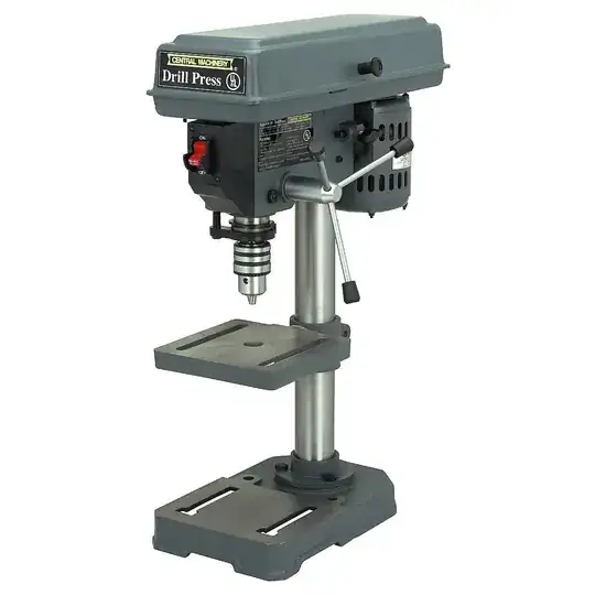

enter image description here $77 if you can find a store get extra drill bits with thick shank and short bits. http://www.harborfreight.com/garage-shop/stationary-drill-press/5-speed-drill-press-38119.html Overall dimensions: 23" H x 17" W x 7" D

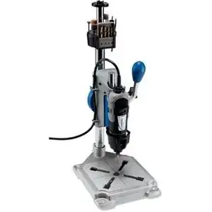

Or buy thisenter image description here
    My experience with the Dremel drill press is that there's too much slop for this application. Fiberglass doesn't have much give, so the little bits snap *very* easily. Maybe it'd be okay for phenolic PCBs, but I would get a "real" drill press. – mng Nov 29 '12 at 02:48
    Yes some have too much bearing slop. – Tony Stewart EE75 Nov 29 '12 at 03:55
