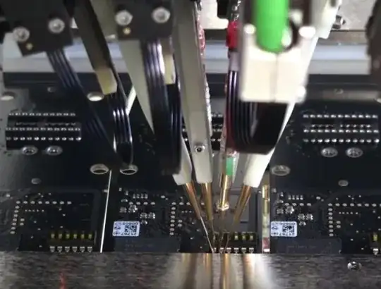

Testing the PCB itself after assembly is done by one of two machines:
Bed of nails: https://www.youtube.com/watch?v=ReB51Hxvmo8 enter image description here
Flying Leads: https://www.youtube.com/watch?v=7xunyJwjKl0 enter image description here
