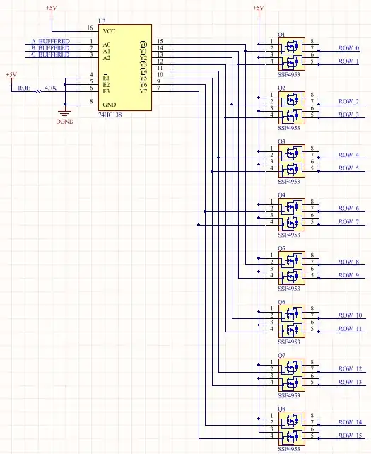

You might be wondering how the 8 bits from the decoder can be used to select 16 total rows. The trick used here is to select rows in parallel. For example, when the 1st row (Row 0) is selected, also select the 9th row (Row 8). Using this technique implies that we must supply data for the columns for two unique rows at a time. (More on this later)
The outputs of the decoder can only handle low currents and cannot drive a row of LEDs directly. To remedy this, a P-Channel MOSFET is used as a switch, providing us the high current we need to drive a row of LEDs. You can see that the decoder outputs are shared between every 8 outputs (0 and 8, 1 and 9, repeating that pattern until row 7 and 15)
Fig 2. 74HC138D schematic showing output MOSFETs
