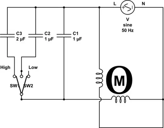

I have never seen series resistors or autotransformers used for CEILING FAN speed control. Prior to triacs though, wall mount fan speed controls were potentiometers or rheostats, which suffered from producing significant heat in the switch box, hence the movement away from them as an external way to control fan speed. All I have seen, prior to external voltage control, is a set of series capacitors built into the fan and the external control being just a set of switches for 2, 3 or 4 speeds, like this: enter image description here

The ceiling fan has a split-phase, capacitor-run motor with variable-voltage speed control.
Before thyristor control took over, series voltage-dropping resistors were used for speed control.
Here's the schematic.
A rotary switch was used in the regulator to select 5 speeds through 4 series-connected, wire-wound resistors. Power wastage in the voltage-dropping resistors was inevitable. The heat generated was detrimental to the regulator and its surroundings.
The right but costlier solution was the autotransformer which was seldom used.
