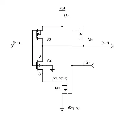

We created a schematic for the posted NAND2 layout (with the electrically correct connections (treating drain and source as asymmetrical): The NAND2 circuit posted
We could not find any SPICE model cards for a channel length L=2u (that large a process has not been used in integrated circuit design for thirty years or more), so we used BSIM4 model cards for nmos and pmos (and provide a link to those files at our GitHub account) suitable for the NAND2 (and INV) 45nm PDK cell layout (and power supply voltage, operating frequency and load capacitance from the relevant standard cell library).
We write circuit files to run in Ngspice-27. Hopefully the code comments and discussion here will make adapting the methods to other SPICE variations.
MOSFETs in CMOS gates are voltage-controlled switches so it would be inappropriate to drive them with a current source if the intent is to measure gate input capacitance seen by another CMOS driving circuit (that is the goal we have set here). Accordingly, we use roughly the output \$R_{ds}\$ of a CMOS circuit for our standard library 45 nm process, \$1 \, \mathrm{k}\Omega\$, resistor between the pulse generator \$^+\$lead in series with the connection to the NAND2 X1 input (in1) input which is our test target for dynamic input capacitance.
We will use the so-called differential form of the electrostatics definition \$C =Q/V\$ of capacitance: $$ C = \frac{dQ}{dV} $$

* measure input capacitance of the NAND:
 let rcurrent = ( (pulseinput - in1) / @rtotargetc[resistance] )
 echo "charge transferred to NAND input: (Coulombs)"
 meas tran incurlh INTEG rcurrent from=0 to=$&TriseOrFallPrintable
 echo "voltage change on NAND input: (Volts)"
 meas tran maxin1 MAX in1 from=0 to=$&TriseOrFallPrintable
 echo ""
 echo "capacitance of NAND input measured, fF:"
 let NANDincap = (incurlh / maxin1)*1e15
 print NANDincap
 echo ""
 settype current rcurrent
 plot rcurrent xl 0 $&TriseOrFallPrintable
+ title "NAND in1 current L to H"
 plot in1 xl 0 $&TriseOrFallPrintable
+ title "NAND in1 gate voltage L to H"
 echo "(Nangate typical build library suggests"
 echo "NAND2_X1 A1 input is 1.599 fF)"
 echo ""
 echo "Load capacitance on NAND output:  "
 echo $&NANDLoadCapacitancePrintable " fF"
 echo ""
 echo "Test frequency was " $&testfreqPrintable " MHz"
 echo "Input rise/fall time was " $&TriseOrFallPrintable " s"
 echo "pulse source output impedance: (ohms)"
 print @RTOTARGETC[resistance]
 echo "Vdd supply voltage was "
 echo $&DCsupplyVoltageForCTL " volts DC"
.endc
* PULSE DRIVE of NAND input 1
VIN1 PulseInput 0 PULSE(0 {DCsupplyVoltage}
+ 0 {TriseOrFall} {TriseOrFall} {PulseWidth} {testperiod})
* transient analysis
.tran 'transstepsize' 'ttime'
.END
In the Ngspice-27 code above (in the CONTROL section; note that we give Ngspice variable names from code above in parentheses) we:
  • obtain the voltage drop across the pulse source resistor (rtotargetc) by taking the difference of the voltage from the pulse generator ideal voltage source (pulseinput) and the voltage at the NAND2 input (in1). This is a vector (a matrix of data with an element for each time step of the simulation) which will be the voltage drop across the source resistance for each simulation time step (because we are running a transient analysis)
  • obtain the current flow (rcurrent) into the NAND2 input in1 by dividing the voltage drop across the pulse source resistor (the vector above) by the scalar resistance of the source (rtotargetc).
  • integrate that gate input current (the rcurrent vector) from zero to the rise time of the pulse stimulus (TriseOrFallPrintable). store this in variable (incurlh). This is the charge transferred to the gate input over the interval of integration.
  • obtain the voltage change from zero to the maximum, i.e., the maximum value from zero to the rise time of the pulse stimulus (TriseOrFallPrintable). store that in variable (maxin1).
  • divide the charge transferred (incurlh) by the voltage change (maxin1) and echo that capacitance value to the screen.
Terminal output from the Ngspice-27 code run above:
incurlh             =  1.39093e-15 from=  0.00000e+00 to=  1.00000e-10
maxin1              =  1.088130e+00 at=  1.000000e-10
nandincap = 1.278276e+00
59  fF
Test frequency was  1000  MHz
Input rise/fall time was  1E-10  s
@rtotargetc[resistance] = 1.000000e+03
1.1  volts DC
We measure \$1.278276 \, \mathrm{fF}\$ above, \$20 \%\$ lower than Nangate standard library typical corner suggested value of \$1.599 \, \mathrm{fF}\$. CBCM (charge-based capacitance measurement) is more accurate (within a few percent), but the CBCM method requires more circuit code.
Why test frequency of \$1 \, \mathrm{GHz}\$? We made use of the familiar relation between rise time \$t_r\$ and signal \$-3 \, \mathrm{dB}\$ cutoff frequency, \$f_{-3 \, \mathrm{dB}}=0.35/t_r\$.
One of the Nangate stdcells-databook (for our 45nm CMOS process) applicable test input rise time specifications for our typical corner circuit NAND2_X1 loaded with \$C_L = 59.3567 \, \mathrm{fF}\$ is \$0.1985 \, \mathrm{ns}\$. \$t_r = 0.1985 \, \mathrm{ns}\$ is then roughly equivalent to a clock speed of \$1.8 \, \mathrm{GHz}\$. $$ 0.35 / 0.1985 \, \mathrm{ns} = 1.8 \, \mathrm{GHz} $$
Transit time estimates also put us in this general neighborhood, so we went with the conservative \$1\, \mathrm{GHz}\$, maximum clock estimates not necessarily being the reliably usable frequency of operation. Edge rate enters in also. You will note in the Ngspice-27 code that we automate the specification of rise/fall time of the input signal, using 20% of the pulse width, the latter being half the test frequency period. The frequency and rise time used is printed in the terminal after a run (as seen above, i.e., rise time was \$100 \, \mathrm{ps}\$ and test frequency \$1\, \mathrm{GHz}\$).
Why \$V_{dd} = 1.1 \, \mathrm{V}\$? That is the specified voltage supply for this typical corner in 45nm CMOS (VTL).
What about output resistance of the NAND2 gate? We treat the output voltage waveform of the switch as an exponential with a time constant defined by \$R_S\$ and \$C_{eq}\$.
$$ V_o = V \left[ 1 - \exp \left(\frac{-t}{R_S C_{eq}} \right) \right] $$
where \$R_S\$ is the output impedance of the gate and \$C_{eq}\$ the equivalent capacitive load on the output. For our purposes, \$C_{eg}=C_L= 59 \, \mathrm{fF}\$ (to be clear, we hang a \$59 \, \mathrm{fF}\$ capacitor on the output of the NAND gate, as we did above), which should dominate any intrinsic capacitance of the PMOS or NMOS transistors.
Considering the equivalent output resistance \$R_S=R_{DS}\$ of the PMOS transistor in the output transition from LOW to HIGH, our time interval will be the rise time \$t_r\$ which we define here as the time required to rise from \$0.1\$ to \$0.9\$ of the final output voltage at the NAND2 output. We solve for \$t_r\$ using the equation above:
$$ \begin{align} \frac{V_o}{V} &= 0.9 = \left[ \exp \left(\frac{-t_{0.9V}}{R_S C_{eq}} \right) \right] \nonumber \\[1ex] \ln(0.9) &= -0.1053 = \left(\frac{-t_{0.9V}}{R_S C_{eq}} \right) \quad \quad \Longrightarrow 0.1053R_S C_{eq} = t_{0.9V} \nonumber \\[1ex] \frac{V_o}{V} &= 0.1 = \left[ \exp \left(\frac{-t_{0.1V}}{R_S C_{eq}} \right) \right] \nonumber \\[1ex] \ln(0.1) &= -2.3026 = \left(\frac{-t_{0.1V}}{R_S C_{eq}} \right) \quad \quad \Longrightarrow 2.3026 R_S C_{eq} = t_{0.1V} \nonumber \\[1ex] t_r &= R_S C_{eq} \left( t_{0.1V} - t_{0.9V}\right) = 2.19722 (R_S C_{eq}) \approx 2.2 (R_S C_{eq}) \nonumber \\[1ex] \end{align} $$
Knowing \$C_{eq}=C_L\$, if we measure the times at which the \$0.1\$ and \$0.9\$ voltage points on the rising output transition occur to obtain \$t_r\$, we then obtain an estimate of the PMOS drain source resistance with \$R_S= R_{DS} = t_r /(2.2 C_L\$.
First we obtain the final voltage of our output rising signal, selecting an interval to measure on where NAND (out) appears to be leveling out, e.g., \$t=0.3\$ to \$t=0.4 \, \mathrm{ns}\$ using Ngspice-27 interactive commands in the terminal window after running the simulation:
ngspice 1 -> meas tran maxinvolt MAX_AT out  from=0.300n to=0.400n
maxinvolt           =  3.999750e-10 with=  1.094780e+00
It appears our final voltage on NAND (out) rising will be \$1.09478 \, \mathrm{V}\$. We then calculate the \$0.1\$ and \$0.9\$ fractions of that voltage, making use of Ngspice interactive calculator capability:
ngspice 1 -> print 1.094780e+00*0.1
1.094780e+00*0.1 = 1.094780e-01
ngspice 1 -> print 1.094780e+00*0.9
1.094780e+00*0.9 = 9.853020e-01
We now have the two output voltage trigger points, so will enter the Ngspice command to measure the time difference between the output out at those two points:
meas tran tdiff TRIG out VAL=1.094780e-01 RISE=1 TARG out VAL=9.853020e-01 RISE=1
And response in terminal:
tdiff= 1.231943e-10 targ= 2.910126e-10 trig=1.678183e-10
We obtain \$t_r = 123.1943 \, \mathrm{ps}\$ for the \$\Delta t\$ (between \$t_{0.1V}\$ and \$t_{0.9V}\$). Now we apply our equation above using our load capacitance value of \$C_L= 59 \, \mathrm{fF}\$:
ngspice 1 -> print 1.231943e-10/(2.2*59e-15)
1.231943e-10/(2.2*59e-15) = 9.491086e+02
We obtain an estimated average \$R_{ds}= 949 \, \Omega\$ for the single M3 PMOS transistor (see NAND schematic given earlier) in saturated pullup mode, i.e., charging the output capacitance \$C_L\$.
