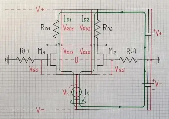

MOSFET differential pair
Fig. 1. MOSFET differential pair
Structure. It consists of two voltage (source) followers which outputs are joined. To bias both transistors (from the side of the sources), the common point is connected through a common element to a negative power supply. This element has the property to keep the current through itself constant. That is why it is named "current source" although it is not a source. It can be thought as of a "current-stabilizing dynamic resistor" that is usually implemented by another MOSFET with constant gate voltage.
VIN = 0. To investigate how the transistors are biased, the input voltage sources are excluded. The gates are simply grounded through resistors R(-) and R(+) so that the bias "current source" can drive the transistors from the side of sources. It makes them adjust their gate-source voltages until the total current through transistors becomes equal to the desired bias current.
VIN = var. Then the input voltages can be applied to gates... and can be varied simultaneously (common mode). The common source point will "move" but the bias current will stay constant.

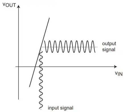

When I started learning CMOS analog IC design I had many similar questions. Your circuit is from Razavi. It is rather to explain amplification properties of CMOS transistors:
Above picture is from: https://ocw.mit.edu/courses/electrical-engineering-and-computer-science/6-012-microelectronic-devices-and-circuits-fall-2005/lecture-notes/lecture19annotat.pdf
Please read it. You have a lot explained there.
In your picture the input signal Vin is on the gate while the output signal is created on the Rd resistor. Depending what is your Vin DC voltage and Vin AC voltage you will get different Vout output signal.
