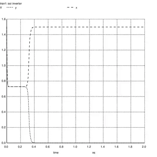

One of the metastable starting conditions also looks fine, with an initial metastable period and a stable outcome:
X = 1.5 V, Y = 1.5 V: X = 1.5 V, Y = 1.5 V

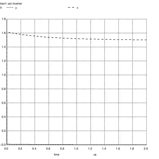

The other metastable starting condition, however, produces this:
X = 0 V, Y = 0 V: X = 0 V, Y = 0 V
This looks different, because the voltage overshoots to 1.6 V. A longer simulation time show that it takes about 2 us to settle to 1.5 V:
X = 0 V, Y = 0 V, 2 us simulation time
Now this is still fine, I didn't expect both cases to look the same. My problem is that the values change drastically when I change the simulation step size.
