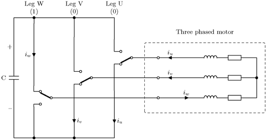

Look at one of its (other 2 seem similar). You don't need to think too complicate let's think this way. it's 4 N-chanel FET.
  1. If read signal go high, high side of phase will conduct, and phase voltage be +V.
  2. If green signal go high, Low side of phase will conduct, and phase voltage be -V.
  3. The motor act like Low-pass filter so it average signal voltage so we can calculate from duty cycle of V+ and V- To make this assumption true, we must keep phase voltage V+ Or V- so we can average its. If you make float state (high impedance) the formula can't be true because we can't define voltage of floating pin (actually it will depend on Back EMF) to make it precise sine wave it has to done this way.

The trick here is to minimize interference as much as possible.
Lets start with a simplified view.
In sine-wave BLDC control, you want to supply the motor with 3 sine-waves 120 degrees offset from each other. If you would try to do this with just an analog voltage, it would prove very inefficient. Thus modern motor controllers apply a PWM signal and let the motor filter it. By insuring that at least one side of each half bridge is on, we can model the system as follows.
By then varying the PWM of each "switch", the motor will smooth it out and behave as if it is getting 3-phase AC. This technique is called SVM (Space Vector Modulation).
