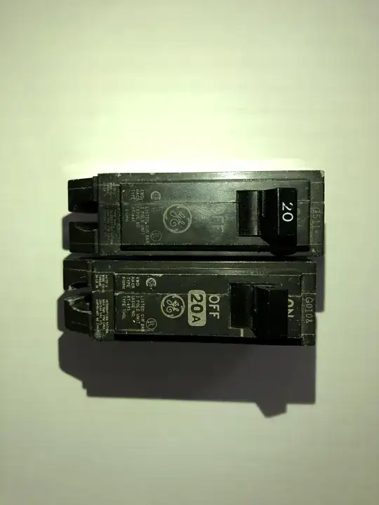

Let's assume that I want to use a 20-amp GE AC circuit breaker in a DC circuit. So, after testing it in a DC circuit with some loads and ammeter + clamp DC amp meter I find the current at which the breaker trips. Let's assume as an example this is 45 amps. So, is it possible to use the AC circuit breaker in the DC circuit on a permanent basis? I've seen a YouTube clip where a person is using an AC 6-amp 230V breaker with a DC circuit and it tripped at 13 amps when loaded.
Are there any significant safety hazards with this technique? I mean I was thinking since it's the current that matters maybe these breakers can be used with 6V/12V/24V circuits where the currents are generally going to be drawing only under 20 amps in the above mentioned case while using, but in a short circuit scenario, the current will be in 35A to 55A range thus causing the breaker to trip.
Update: I had these two breakers from the old panel in my storeroom. What you guys said is very true. It seems to be quite dangerous to use them in DC too. I have a high-current 12/24V supply capable of 35-amp output. But I’ll only be using it under 20 amps mostly. I build these supplies from UPS transformers. So, I tried to connect the three supplies and I had built to the GE breaker, in short, to see its response only 2 seconds power ON. The first one was with the biggest transformer from a 2000VA UPS. It had very thick low voltage windings (10AWG likely) and shoutings the AC low voltage caused the breaker to trip in 39-41ms. With another transformer from a 700VA UPS from low voltage AC side, it tripped at around 1.17s and finally from a 300VA UPS transformer low voltage AC the breaker did not trip. Now trying the first two transformers I’m dead short on the breaker via a 50 Amp rectifier (Imax peak 400A briefly) I was surprised the breaker didn’t trip even after 2 seconds and I immediately gave up the DC breaker idea. I’ll put the breaker on the AC low-voltage high-current side for safety and add a 400-amp rectifier to protect in case of a dead short.
GE 20-amp breaker

    Just use a DC breaker designed to break a DC arc at your rated voltage and current. –  May 01 '20 at 21:52
    Some 230 Vac breakers do have an 24 Vdc rating, so your question isn’t that far out. Check the datasheet! – winny May 01 '20 at 22:23
    Why are you married to "GE breakers I found in the storeroom"? *Do you have any grasp of how cheap North American power equipment is?* **Square D "QO" panels cost $30. Square D breakers cost $9**. *And they're considered overpriced*. That's all it costs to do the job properly... why go through backflips to use the wrong thing, when the right thing is literally on the shelves at Home Depot waiting for you? Get QO and do your test again. I bet it passes. – Harper - Reinstate Monica May 02 '20 at 17:48
  • @Harper-ReinstateMonica I don't use that GE breaker in my house anymore. They were the old ones when it got replaced by AFCI modern ones. I could get a Square D new one but the GE one works fine on the high current AC side of the transformer. It trips in under a second. As for the DC side for safety concerns as you guys have been mentioning I'll need something like this. Yeah I'll have to shell out $20-22 for two. https://solarconduit.com/shop/electrical/electrical-fuses-breakers-etc/dc-breakers-and-fuses/mnepv20-pv-breaker-20a-150vdc.html – The_Vintage_Collector May 02 '20 at 18:31
    You don't have to mail-order weird-ass breakers at $21 a pop + $18 shipping. **I recommend the Square D "QO" type for DC power specifically for DC**. That is, I am saying use QO on the DC side since all are [rated for 48V DC](https://download.schneider-electric.com/files?p_enDocType=Catalog&p_File_Name=0100CT1901_SEC-07.pdf&p_Doc_Ref=0100CT1901_SEC-07) and some are rated for 125 V DC. They are sold at the local hardware store for $9 a pop, and you'll need a $30 enclosure once. You need one anyway! – Harper - Reinstate Monica May 02 '20 at 19:09
    Here's [a breaker](https://www.homedepot.com/p/Square-D-QO-20-Amp-Single-Pole-Circuit-Breaker-QO120CP/100028706) Here's [a panel](https://www.homedepot.com/p/Square-D-QO-100-Amp-6-Space-12-Circuit-Indoor-Main-Lug-Load-Center-with-Surface-Mount-Cover-QO612L100SCP/100148926) to put it in. Not so bad, since you can order it online for local pickup, and just drive to Home Depot, Lowes whatever and pick it up. Lots of expansion room too. – Harper - Reinstate Monica May 02 '20 at 19:11
  • @Harper-ReinstateMonica -- the QO line is limited to 48VDC systems (with a few QOUs that go up to 60VDC maximum) – ThreePhaseEel May 03 '20 at 00:04
