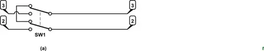

Figure 1. (a) What you want. (b) What you're considering using.
You need a switch with two normally open (NO) contacts and one normally closed (NC).
The switch you've chosen has only one contact and two terminals so I suspect that the LED common connection is through the body of the switch and requires mounting in a panel connected to negative. (That's usually easy on a car dashboard.)
It is not suitable for your application.
simulate this circuit
Figure 2. The requirements can be met with a double-pole, double-throw, 2P2T, switch.

  • Fantastic, thank you for explaining that, I think it makes sense! So if I take the LED out of the equation, what is the simplest switch type I could just to just say 'when in on position, don't short pin 2 and 3, when in off position, short 2 and 3'? – S_R Apr 29 '20 at 22:27
  • I've given you that information in the answer. – Transistor Apr 29 '20 at 22:29
