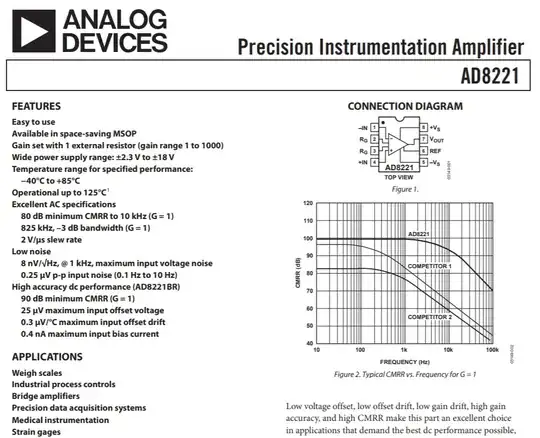

Given that the OP has revealed that the DAQ is the DT9816-S, in order to get the most from converting its very good single ended input to a differential input, I would suggest using the AD8221 instrumentation amplifier as a decent choice. I've used them myself when designing DAQs for test beds and found them to be pretty good: -

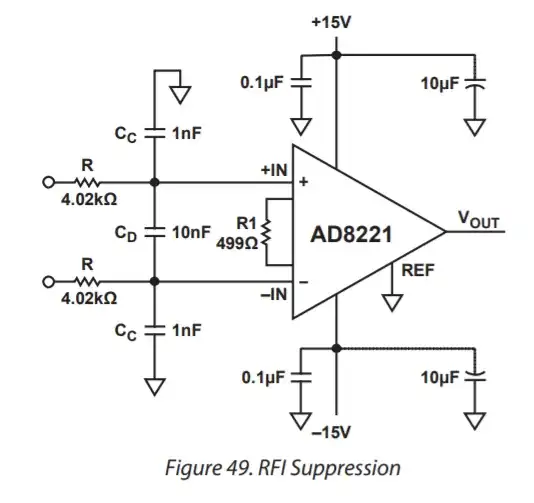

Because of the need to protect sensitive inputs I would use series resistors with each input. They will also allow for a little RFI filtering: -
The gain set resistor can be left open circuit for G = 1 operation.
  • Great answer. Is there a limit to the common mode across -IN and +IN? – J Collins Apr 30 '20 at 10:11
  • Running on +/- 15 volt rails should hopefully allow several volts of CM noise or offset to be tolerated. Adding the filter means CM high frequency noise would have less effect. Having a lower cut-off frequency for the filter improves this more. See also fig 17 in the data sheet for common mode rejection characteristics. Circa 90 dB rejection at 20 kHz. – Andy aka Apr 30 '20 at 10:21
  • Okay so the key is that the two circuits need to be at the same ballpark ground within the supply range of the amplifier. There can't be arbitrary thousands of volts different. Does this suggest say an oscillocope handles the situation differently? – J Collins Apr 30 '20 at 11:20
  • An oscilloscope (by default) does not have a differential input and is prone to all sorts of common mode noise problems. – Andy aka Apr 30 '20 at 11:25
