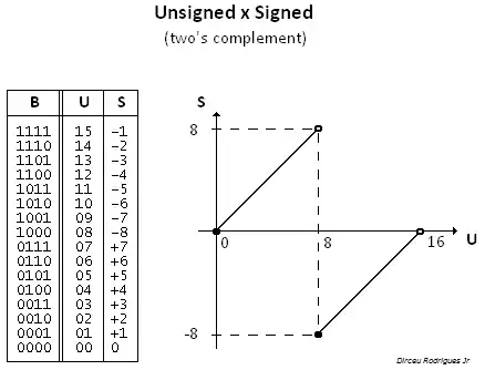

My notation: n x n → m
Two operands with length "n" bits and product with length "m" bits.
1. Multiplication result depends on operands being signed /unsigned
Ex. 4x4 → 8:
Fh x Fh = E1h, unsigned integer: 15 x 15
Fh x Fh = 01h, signed integer: -1 x -1
Note: The 4 LSbs are the same for signed and unsigned multiplication.
2. Signed product Fh x 8h (-1 x -8) depends on target size
4 x 4 → 8: 08h (or 8), OK
4 x 4 → 4: 8h (or -8), INCORRECT (overflow).
Generalization: Negating (or getting the two's complement) a byte containing -128, a word containing -32768, or a double word containing -2147483648, cause no changing in the operand, but the NEG instruction will set the overflow flag (ex. for x86 architecture).
