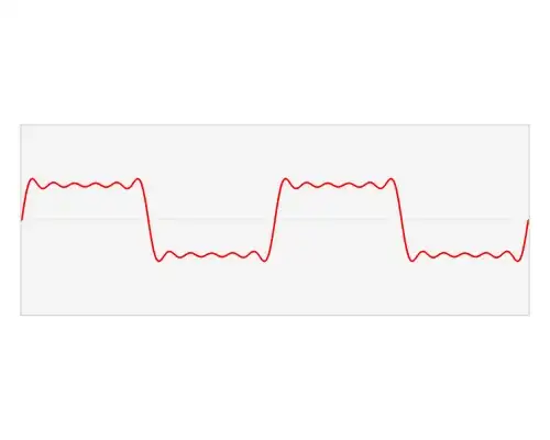

Fourier was saying that any periodic wave can be made up of the fundamental and its harmonics in various ratios.
Figure 1. This fabulous illustration of the Fourier Transform by Lucas V. Barbosa on Wikipedia's Fourier transform page shows the transformation of a periodic waveform from the time domain to the frequency domain. The frequency plot shows the relative strength of the harmonics with clarity that could not be obtained from staring at the time plot.
  • It should be apparent that the more square the time domain waveform is then the more harmonics you will have and these should be visible in the frequency domain.
