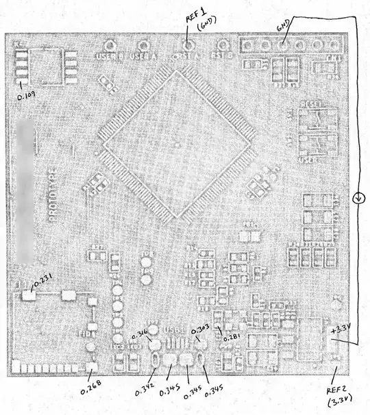

This is a late answer, expanding on The Photon’s answer. I realize that few people will see this now, but I can reference it when similar questions are asked in the future. Over my long career, I became known as the expert at finding shorts at the large company where I worked, so besides the shorts that I had on my own projects, other people would ask for help with their boards, I isolated a lot of shorts over the years.
The OP sent me a PWB with a short so I could document some of the nuances of the process. I am describing the process for a power to ground short, these are usually the most difficult to find because of the low resistances involved.
To inject a current into the short, solder wires onto the PWB. You need a minimum of 3, power, ground, and a reference point. The reference point will be either power or ground, start with ground since most PWBs will have more ground points to access. Don’t try to share the reference with the current injection wires, since you are measuring tiny voltages, the voltage drop on these wires can swamp out the voltage drop on the planes. A wire with current flowing will heat up and the voltage drop will drift making the isolation process much harder or impossible.
I usually put the injection points on opposite ends of the board. If the short is near an injection point, the results can be confusing. This way, the short will be far from at least one of the injection points. The reference point connection should be close to the injection point, but try not to put it where a surface trace will share the current. Or, you can have the same problem described in the previous paragraph.
In the picture, the alligator clips are attached to the current injection points, the Q-ball is connected to the ground reference point.
The voltage drop across the plane will be in the millivolt range, so you want something 100 or 1000 times more sensitive to find the voltage gradients. Ideally you want a voltmeter with microvolt resolution or better, however, a resolution of 10 microvolts might be sufficient for some cases.
A small company or hobbyist may not have a meter that is sensitive enough. But, it isn’t hard to build a 1000X amplifier. Most common DMMs have 1 millivolt resolution. The 1000X amp will give you microvolt resolution. See the bottom of this answer for more details on how to build a 1000X amp.
Using a lab power supply, set the voltage to 0.5V. If the short opens up, you want this to be low enough to prevent damage on PWBs that have already been populated. Set the current limit to a few hundred milliamps. You may need to increase it later to get a sufficient voltage gradient in the planes. I used 500 mA for this example.
To start, I am assuming that the reference point is on the ground net. Using the artwork and/or schematic as a reference, probe the ground points on the PWB looking for the largest voltage difference. Try to visualize the current flowing in the plane. Current flow in the copper planes will cause tiny voltage drops. You don’t need to probe every ground point on the board, if the voltage is getting smaller, you are moving in the wrong direction.
When you have found the highest voltage drop, this will usually give you enough of a clue to find the issue. For this PWB, the short was inside two connector mounting holes that are plated through, and connected to ground. Looking at the artwork confirmed that the power plane was not cleared out around the hole causing a short.
If the results seem confusing, sometimes moving the injection points to another location can be helpful.
To confirm, I usually move the reference point to the power net and repeat the measurements, this time probing the power points on the PWB. This PWB doesn’t have a lot of surface power connections so this wasn’t that useful.

  • Thanks for the excellently detailed answer. Just for this whole experience to lead to a take-home lesson, what seems to have caused the power plane to be not cleared around the mounting holes? Would it be a gerber processing issue on the manufacturer's side, or should special care be taken on the design side as this was missed by the DRC? – Ayberk Özgür Apr 27 '20 at 14:32
  • Also, I'm making myself a x1000 amp as soon as possible, thanks for detailing this use case. – Ayberk Özgür Apr 27 '20 at 14:34
