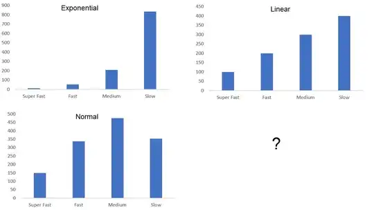

Let's say I produce 1000 FPGAs, what percentage of these 1000 FPGAs are considered super fast, fast, medium, and slow? Does it look like a normal distribution, exponential, linear, etc.? Does anyone have any data they can share or point me to regarding this?

    That is extremely proprietary information that any real manufacturer keeps to itself. Why is the nature of the distribution of interest to you? – Dave Tweed Apr 17 '20 at 21:26
    I expected the numbers would probably be secret, but figure someone someone will at least know the shape of the distribution from an academic perspective. Just curiosity thinking in terms of roughly how many -1, -2, -3 parts are sitting around after production. – Charles Clayton Apr 17 '20 at 21:31
  • All the die from a particular wafer or wafer lot (group of wafers) are going to have very tightly grouped performance (speed, in this case) numbers. While the distribution may very be normal, it's normal with a very low 3 sigma (spread) value. – SteveSh Jun 04 '20 at 19:42

That will absolutely depend on the type of component you're producing, the kind of process you have, and the actual fab. Since this is only kind of a failure process, I don't think any of your simple statistics will actually represent any "continuous metric" of "die quality" (whatever that might be) overly well. With four bins only, you can fit a lot of arbitrary distributions to your data with little or even no error at all – so kind of a pointless question!
Most importantly, however, as the manufacturer, you're the one to define what your "super fast", "fast", "medium" and "slow" categories are, and which dies falls into these.
That has more to do with financial aspects (it might be wise to more aggressively sell more dies as "slow" than to test them extensively, if demand is slower than expected, for example), than with technical facts. If there's no demand for a million USD10,000 FPGA, well you better cripple the ones you got out of this luckily very good production run and sell them for USD600 a piece instead of letting them rot in your storage!

    Exactly. The raw distribution is probably Normal, as most distributions are, but you bin parts based on economic considerations. – Mattman944 Apr 17 '20 at 22:08
  • @Mattman944 Thanks! But consider this: Even if the underlying phenomenon for speed is somewhat normally distributed (it's probably not, this is a mixture of a failure process, which is "if one in a long chain of things go wrong", not "the sum of iid variables" and things that probably aren't independent), then you'd still have cut-off tails, and discretization – it's hardly a "normal" variable afterwardss! – Marcus Müller Apr 17 '20 at 22:11
