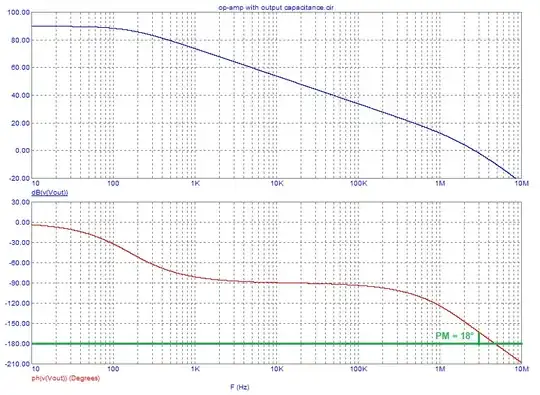

Next is the open-loop gain characteristic in figure 33: -
I've taken the liberty of drawing a red-line at unity gain. At unity gain (about 3 MHz) can you see that the phase shift line corresponds to about 150 degrees? This means it is 30 degrees away from becoming an oscillator i.e. 30 degrees away from regular inverting feedback becoming non-inverting (or positive) feedback. This 30 degrees is called "the phase margin" and you want that to be as big as possible in order to reduce overshoot and (god forbid) avoid turning the circuit into an oscillator.
To help see this more clearly I've added simulation results. Here's the first one: -
Adding 100 pF moves the phase margin lower i.e. the 30 degrees margin becomes less. How much less does it become you might ask. The answer begins in figure 10 where I estimated the output resistance of the op-amp and got 125 ohms.
That resistance plus 100 pF forms a low pass filter of cut-off 12.7 MHz. At this frequency, the added phase shift is 45 degrees. But, importantly, at 3 MHz the phase shift is only about 12 degrees. Therefore, with 100 pF connected to the output our phase margin has reduced from 30 degrees to 18 degrees. I've used this tool to help me visualize that phase shift. I could calculate it but why bother when Mr Okawa provides such nice tools.
Again, I've added a simulation result: -
If the capacitance were 150 pF, the cut-off has reduced to 8.4 MHz but, of significance, at 3 MHz, the phase shift is 20 degrees and our phase margin has reduced to only 10 degrees. This suggests that the device won't oscillate but I'm just using typical values and not worst case.
