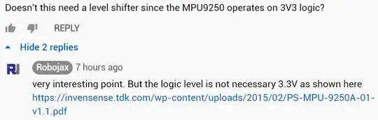

However, no one is mentioning using a level shifter with the MPU9250 despite it working on 3.3 V. Robojax has even told me on his Youtube channel that it is not required. How can this be?
Robojax saying level shifter is not required

Can anyone justify the reason for this or disprove it?
