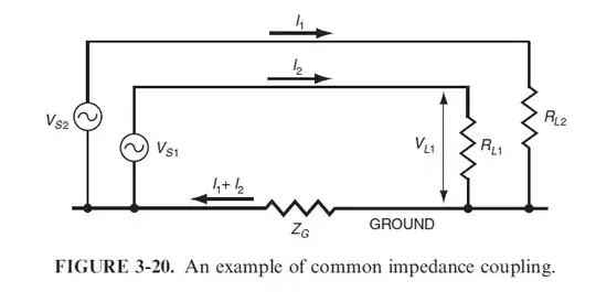

The confusion might be from considering the common impedance coupling shown in figure below EMC compatibility Figure 3-20
In this circuit VL1 = VS1 + ZG * (I1 + I2).
This means that the voltage across the load RL1 is no longer a function of I1 but also a function of I2.
Remember: A high-impedance ground at high frequency is caused by too much inductance while at low-frequency this is caused by too much resistance.
Single-point grounds overcome this by separating ground currents that are likely to interfere with each other and by forcing them to flow on different conductors. This approach is effective at low frequency. However, the signal current paths and long lead lengths associated with single-point increase inductance, which is bad at high frequencies.

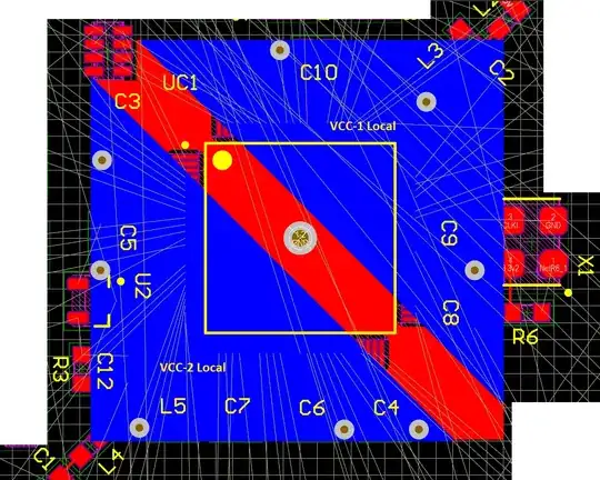

My layout is now like this :
In first image top layer is shown , purple is solder mask (shown here to make capacitor pads clearer ) . The line under C9 is the 24mhz clock . all caps are 100nF 0603.
Second image shows the bottom layer . the 2 triangles are Vcc-1 and Vcc-2 . they are connected to main Vdd plane on the top layer after L-C-L network.
Middle layer are not shown in both images to avoid over crowding the view.

  • Single big via? How much DC current would you estimate passes that via? What frequency AC signals (such as SPI clock) you have on the MCU that need ground currents to pass through that single via? – Justme Apr 16 '20 at 20:15
  • it is just a via , just made it a little bigger (hole=1mm , diameter 1.6mm) to reduce inductance – ElectronS Apr 17 '20 at 00:56
  • The circuit looks fine , however the Power planes on bottom layer seem pointless , you can use thick traces and that would be enough i guess – Sarah Apr 21 '20 at 16:41
