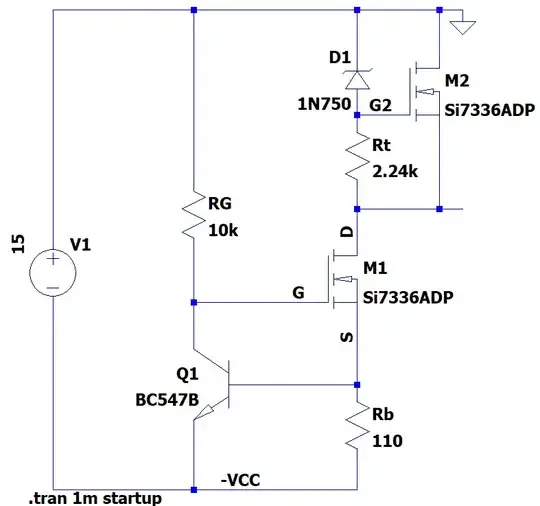

Although not the most elegant solution, if you still want to use a NJFET, you have to ensure that the drain voltage of the FET is not fixed by the \$V_{FWD}\$ of the BJT. I just added some random values, and you would have to optimize it:
circuit_with_modification
EDIT #2
Here is a circuit similar to the one, shown in the video. (After watching the end of the video, I am almost sure that he is using a MOSFET instead of a JFET)
How it works
As you already explained, the components \$R_G\$, \$M_1\$, \$Q1\$ and \$R_b\$ form a controlled current sink. Disregarding the upper section for the moment, once the circuit is turned on, the source voltage of the MOSFET \$M_1\$ increases until it reaches \$\approx 650mV\$, thus turning on the BJT \$Q_1\$, which provides a negative feedback, which in turn reduces the \$V_{GS}\$ of the \$M_1\$.
There are two requiremts which must be fulfilled for the current source.
$$R_b > \frac{650mV}{I_{sink}}$$
AND
$$R_b > \frac{R_t\cdot 650mV}{V_{cc}-V_Z-650mV}$$
First condition ensures that there's enough current through \$R_b\$ to turn on \$Q_1\$, whereas the second one ensures that the voltage across \$R_b\$ is large enough to turn on \$Q_1\$.
The upper section of the circuit works as follows:
During start up the zener \$D_1\$ ensures that the gate voltage of \$M_2\$ is \$\approx - V_Z = -4.7V\$. At this moment the mosfet is on, and its source voltage starts to ramp ump until its \$V_{GS} < V_{th}\$ which yields an output voltage \$V_{out}\approx -4.7V - V_{th} = -7V \$
circuit_2

  • @vtolentino \$V_{GS_{(OFF)}}\$ equals vto in LTspice model, right? That would be -1.13V for this part, and datasheet shows a \$V_{GS_{(OFF)max}}\$ of -3.5V. So the reason there is current running through Q2, despite \$V_{GS}\$ at about -14V (well below the cut off voltage), is that the drain voltage is held approximately at the same voltage as the gate. For ex., using a 2.24k load, \$V_{GS} = -8.84V\$ and \$V_{DS} = -8.74V\$, so there is no reduction in substrate current. So based on that, I assume Q2 is not working as it should, in saturation region. How can I fix this still using a JFET? – tfm Apr 11 '20 at 16:48
  • You cannot fix it because for a JFET the voltage at the gate needs to be lower than the voltage at the source. Thi is why you shoude use a MOSFET insted. – G36 Apr 11 '20 at 17:21
  • @HW_SW_Engineer exactly, \$V_{to} = V_{GS_{OFF}}\$. As for your second statement, it is wrong, because you are not considering the pinch off voltage, meaning \$-8.74V < -8.74V + 1.17V = -7.67V\$. I will updated my answer – vtolentino Apr 11 '20 at 17:23
  • Understood it. Can I call this current sink configuration a series feedback pair? – tfm Apr 11 '20 at 17:51
  • Series feedback pair seems to be mostly used to name a npn / pnp pair operating in a negative feedback fashion. But in this case, the same control mechanism is happening, meaning, the JET is being controlled via negative feedback. So, I suppose you can use the same nomenclature. – vtolentino Apr 11 '20 at 18:55
  • @HW_SW_Engineer out of curiosity I watched the last part of teh video and updated my answer accordingly. – vtolentino Apr 11 '20 at 20:11
  • @vtolentino, thank you for your trouble. I believe the expression for \$V_{OUT}\$ would be rather \$V_{OUT} = -V_Z -V_{TH} \approx-7V\$. Gnd is on top... – tfm Apr 12 '20 at 00:52
