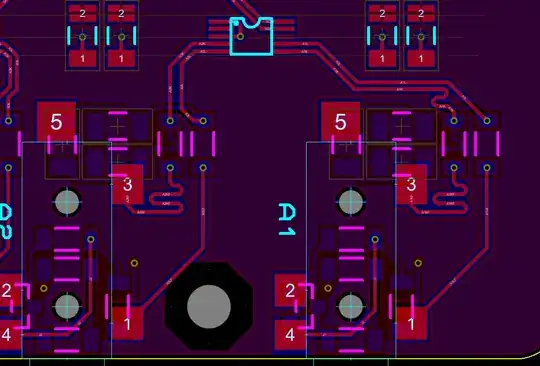

I am designing a PCB which reads analog signals via some ADC, my circuit looks like this:
There are four of those in a single board. My top copper is filled with a power plane (3V3) and bottom copper is filled with a ground plane. The components under the pad 1, 2, 4 of A1 or A2 are the plug detect components, and components near pads 3 and 5 are the filters.
I have learned that the ground of the analog components should be separated from the ground of the digital IC components.
My questions are:
  • If I make another plane for the analog ground how would I connect them to the digital digital ground? Should I use some ferrite? And what values?
  • How big should the distance be between the analog and digital ground?
  • Am I overthinking things? the frequency of the signal that will pass there is only max 70Hz.
I already have a prototype and it works great, but because there are some minor adjustments, the opportunity is there to improve the design. I would like to respect good design practices.

    I (and many others I know) have made a living from fixing separate planes. Shape the planes instead. I separate the power (via filtering) but never the return. There are a lot of answers on this subject including one of mine. https://electronics.stackexchange.com/questions/185306/analog-power-ground-planes-doubts/185320#185320 – Peter Smith Apr 10 '20 at 13:04
  • @PeterSmith shaping seems to be the common answer for articles, separating the ground planes is also be called shaping since they will be connected back to each other somewhere. I apologies it seems to be a lot to take in for me yet. You mention of "make the return currents flow where you want them to go" which of the devices would i particullary look this out for ? the Analog components or the digital components? I assume the digital components is the one responsible for making the noise and messing up the analog signal correcT? – Jake quin Apr 10 '20 at 13:27

  • Unfortunaly i cannot accomodate battery( chemical reaction battery, im not sure if you ment this) to my design. Can you check my proposed [new PCB layout](https://ibb.co/Y8L8Rkz) that utilizes slits in planes from which i was influence by your answer to this [question](https://electronics.stackexchange.com/questions/306862/should-i-really-divide-the-ground-plane-into-analog-and-digital-parts/306896#306896). – Jake quin Apr 12 '20 at 13:29
Generally, these splits of GND planes are made as a function of frequency. As your sampling speed on the ADC goes up, you can see harmonics between the power supply feed-through from the digital and the analog sampling clocks. You can overdo this however, I have seen people arbitrarily spit planes and then had to rectify the ground loops. 70Hz is relatively low speed. If each device on the digital side has it's own capacitor to debounce it, you are unlikely to see feed through on the supplies lines.
For 1GHz sampling ADCs, we generally have matched line lengths and no planes due to how much charge "sloshes" around on the planes.
b degnan
  • 3,167
  • I like how you use the term "sloshes" weirdly enough that gave me a pretty good analogy and mental image of what is happening. So you are saying that its better to keep my current setup rather than me having the chance of not doing it properly? – Jake quin Apr 12 '20 at 09:02
