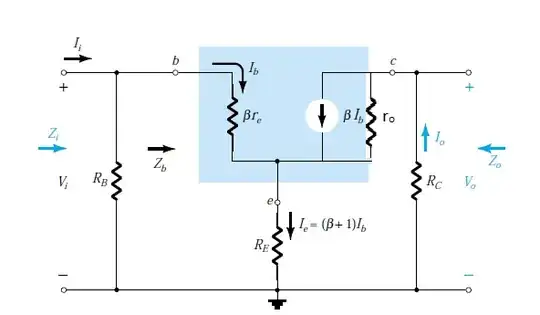

I have been studying the small signal analysis of BJT with re model with the emitter terminal not bypassed. I am able to derive those Zi, Zo,Av, Ai long as ro is assumed to be infinite. But I am unable to find Zi with a finite ro. Following is the circuit diagram:
Below is the equivalent re model: enter image description here
I tried with google, but have not been able to find any. Everywhere the solution is done omitting ro.Kindly help me with the analysis or provide some helpful link. Thanks in advance.

let, beta=B
From my analysis, Vb=Ib[Bre+(B+1)RE]
So, Zb=Vb/Ib= [Bre+(B+1)RE]
Zi=RB||Zb
But the expression for Zb given in the book by Boylestad and Nashelsky is
Zb=Bre+[{(B+1)+RC/ro}/{1+(RC+RE)/ro}]RE
which I am not able to understand. Please explain it.

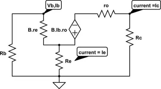

With this diagram
\$V_b = i_b~{\beta}~r_e + i_e ~R_E\$
\$ \beta~i_b~ro = i_e~R_E -(-i_c) [r_o+R_C]\$
\$ i_e = i_b+i_c\$
It gets enter image description here
This problem can be solved by converting the current controlled current source to current controlled voltage source by using source transformation technique. So applying source-transformation technique, this circuit will look like this.
We will obtain two equations, when we apply KVL rule both in input and output side.
Note:
Current through resistor \${\beta}r_e\$ is \$ i_b\$;
Current through \$r_O\$ and \$R_c\$ is \$ i_c\$;
Current through resistor \$R_E\$ is \$ i_e\$ = \$i_c\$ + \$i_b\$
Analysis
For input side,
\$V_b = i_b.{\beta}r_e + {(i_b+i_c)}R_E\$
=> \$V_b = i_b.({\beta}r_e + R_e) + i_c.R_E\$ --------------->equation-1
For output side,
\${i_b}{\beta}{r_o} = {(i_b+i_c)}R_E + {i_c}{R_E} + {i_c}{r_o}\$ --------------->equation-2
From equation-2, we can derive an equation for \$i_c\$ in terms of \$i_b\$.
\$i_c = i_b.\cfrac{({B}r_o-R_E)}{(R_E+R_c+r_o)}\$
Substituting it in equation-1 yields
\$V_b = i_b.({\beta}r_e + R_E) + {({i_b}{.\cfrac{({\beta}r_o-R_E)}{(R_E+R_c+r_o)}})}.{Re}\$
So Ib is common in right hand side. Taking it outside as common,
\$V_b = {i_b}.({{\beta}{r_e} + R_E + {\cfrac{(B.ro-Re)}{(Re+Rc+ro)}}.R_E})\$
Taking \$R_E\$ common from the second and third terms in the RHS, then
\$V_b = {i_b}.({\beta}r_e + ({1 + {\cfrac{({\beta}.r_o-R_E)}{(R_E+R_c+r_o)}}).R_E})\$ ---------->equation-3
\$V_b = {i_b}.({\beta}r_e + (\cfrac{(R_c+(1 + {\beta})r_o)}{(R_E+R_c+r_o)}.R_E)\$
Dividing numerator and denominator of second term in RHS by \$r_o\$ results
\$V_b = {i_b}.({\beta}r_e + (\cfrac{( (1+{\beta})+{\cfrac{Rc}{ro}})}{( 1+{\cfrac{(R_E+Rc)}{ro}})})\$
\$=>Z_B=\cfrac{V_b}{i_b} = {\beta}r_e + (\cfrac{( (1+{\beta})+{\cfrac{Rc}{ro}})}{( 1+{\cfrac{(R_E+Rc)}{ro}})}\$
so circuit input impedance will be \$Z_i=R_b || Z_b\$
