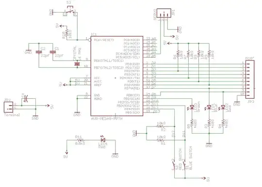

I have created a nice electronic door lock for my dorm room. It is currently an Arduino Diecimila with a servo [un]locking the door. It has a numerical keypad with 3x4 buttons and 5 LED's (2 serie pairs and one single LED). It also currently runs on a cellphone charger.
I have now redesigned it to run on a standalone Arduino (ATmega328), but would really like to have it run on AA batteries or even a 9V battery.
For the software part, I figured I could put sleep calls for certain times inside the loop method to keep the ATmega power consumption as low as possible. And let the LED's "flash" with as long as possible time off.
Question 1
When a button is pressed during the few milliseconds which the board sleeps, will it be "remembered"/"held" until it comes out of sleep and then be picked up as a button press?
What would be the best way to handle this button press on sleep? Can I code it to wake up upon button activity, or must I just let it sleep for e.g. 10m.s. in every loop?
Question 2
How would I approach the math of calculating how many AA batteries are needed to run this device for 10 months?
Also, I don't know how to measure the average power usage per minute or so, since it alternates quickly etc.

  • Coincidentally, this was the same question I posed to myself when designing an electronic door lock. Even with a chunky 10,000mAh rechargeable battery it wasn't worth it. Ended up just using a 250mA DC adapter and an old mobile phone battery as a backup. – Polynomial Nov 19 '12 at 08:38
    15 mA average doesn't sound very conservative to me! The 328 can run at single-digit microamps in sleep mode, and surely you could get away with having it in at least semi-deep sleep a lot of the time. Also, at low frequencies (e.g. 0.5 MHz) you can get by with <1 mA in active mode. Of course, other components (voltage regulators etc.) need to be picked to suit the low-power nature. – exscape Nov 19 '12 at 09:05
  • @exscape LED4 alone will pull 15mA. Activating S1, S2 or S3 will pull another ~0.5mA each due to the pullups. – Polynomial Nov 19 '12 at 09:17
    @Polynomial I didn't look closely at the schematic, but surely the project could be build without a "power LED". Or you could blink it, so that it's on e.g. at half brightness (via PWM), only for say 25 ms every 2 seconds, such that the current use would drop to an average of ~0.09 mA instead of 15. – exscape Nov 19 '12 at 09:25
  • @exscape That's true. Perhaps it is possible to run it for almost a year on a few lithium AA batteries after all, if you put in some extra work to reduce consumption. I'd imagine the average alkaline battery wouldn't do better than 4-6 months though. – Polynomial Nov 19 '12 at 09:29
