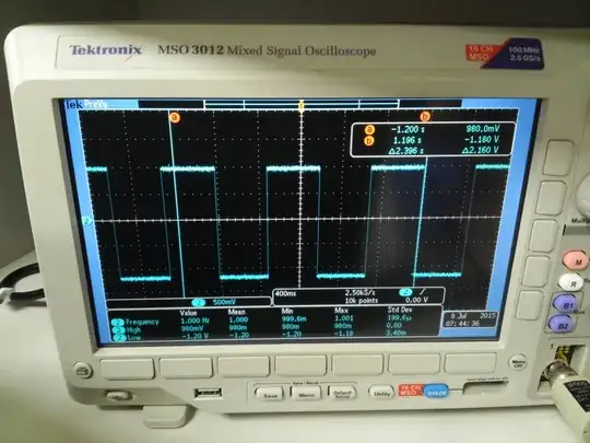

I have probed the circuit again with the oscilloscope; the probe point is the entry point of the input network as explained by the answer below:
Probing the circuit
The result is this, an extremely noisy waveform that in fact, might be a 440Hz audio input:
Oscilloscope screen
