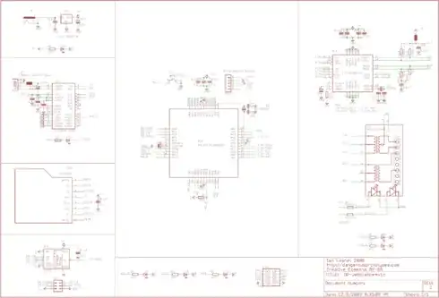

Here are some links:
Dangerous Prototypes web platform
Web platform v1.1 Assembled
