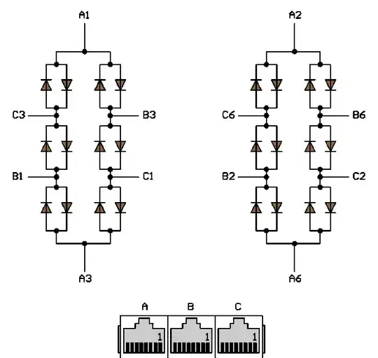

There is an article about building a passive hub (that only supports three devices) here.
There was a question about this particular passive-hub-topology on electonics.stackexcahnge here.

    Great answer, thanks. Out of interest, do you know if there any commercial passive hubs? I did a quick Google and I couldn't find any. – C Nielsen Nov 17 '12 at 05:52
    It looks like you can't get more then 3 ports without active devices. The drawing above is managing to work due to some cleverness with the diode-drop voltage versus the signaling level of the Ethernet interface. I would imagine that it rather strongly violates the official Ethernet specifications. – Connor Wolf Nov 17 '12 at 06:14
