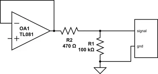

Here is the circuit I am using:

  • Of course the speaker output can be heard by the microphone and is causing acoustical feedback howling because the amplifier gain is 200 times. The power supply has no filtering capacitor so its output is probably bouncing up and down with the oscillation and feeding into the amplifier input through R2. Where is 0.5W coming from? the datasheet shows only 0.14W with severe distortion (the buzzing instead is a smooth tone). Get rid of the breadboard. – Audioguru May 16 '21 at 12:00
Sounds like you built an oscillator instead of an amplifier.
Try removing V1 to reduce the gain and see if the circuit stabilizes.
Try making R1 a low value, more like 10Ohm, not 10k.
Or try adding a small R value on the output. Something on the order of 47 Ohm.

Try adding a 100nF capacitor across the voltage supply between pins 4 & 6.
R1 should be 10R not 10k.
