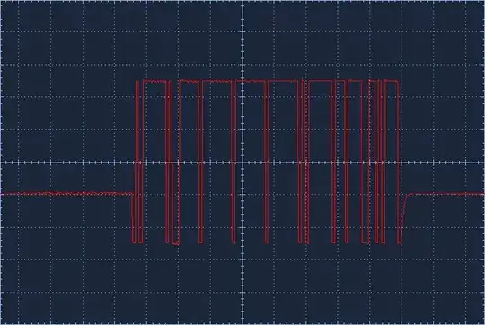

I can see the signals converted by the MAX485 (CPA1114) though the oscilloscope and it seems to be right. The LED on the Modbus server lights on as it sees a Modbus transaction. Still, what I read as result of the request is always 0xE0 (invalid server id) or 0xE2 (timeout).

These are the request signals emitted by the Arduino, that always fail to get a data response, and the other tool, that always succeed:
Arduino request signal

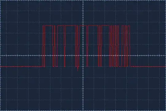

USB/RS485 converter signal

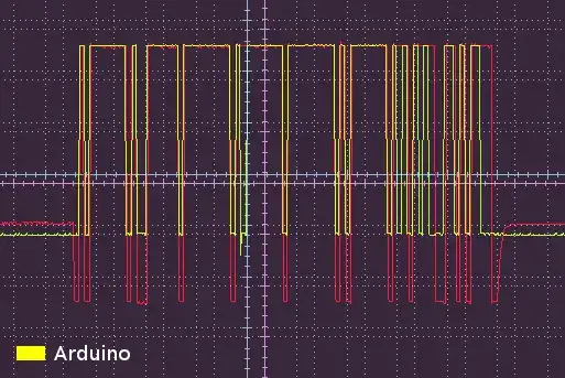

Overlap of the two signals
