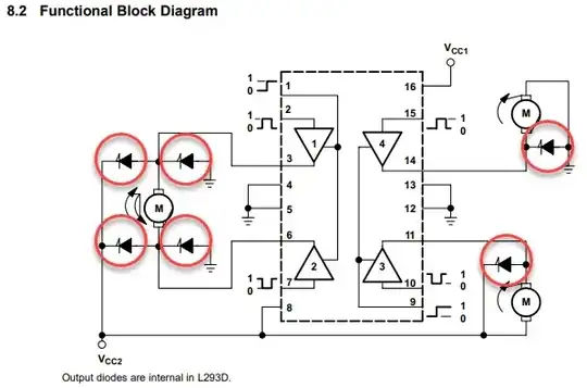

A further factor not clear from the schematic is that snubber diodes should be used to prevent inductive kick-back from the motor's inductance causing damage to the driver's output transistors. While the diodes protect the driver, the capacitors take the "edges" off the current spikes and help reduce EMI, etc.
Figure 2. The L293 datasheet shows that snubber diodes should be connected across the motor unless the D version is used.
The left side of the schematic shows a H-bridge connected motor and the right side shows alternate configurations for single-direction motors - one connected to GND and the other to VCC.

  • But the D version of an L293 already contains the flyback diodes inside IC. – G36 Apr 04 '20 at 12:02
    OK. I didn't find that datasheet. OP should have supplied it. – Transistor Apr 04 '20 at 12:08
  • But read the note below figure 2 that you have posted -> "Output diodes are internal in L293D" – G36 Apr 04 '20 at 12:11
    Ha! I missed that. I'll fix the answer. Thank you. – Transistor Apr 04 '20 at 12:16
