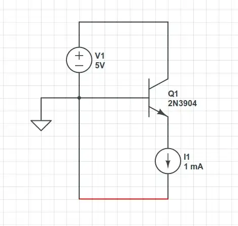

First of all, sorry for my bad english.
Output for Vb: enter image description here
From the schematic above, I redrew the 2N3904 BJT into the modified Gummel-Poon model. enter image description here

But the result seems wrong for me. What do I miss? Can I just take and use the values of Cbc and Cbe from the DC operating analysis log file of LTspice?
