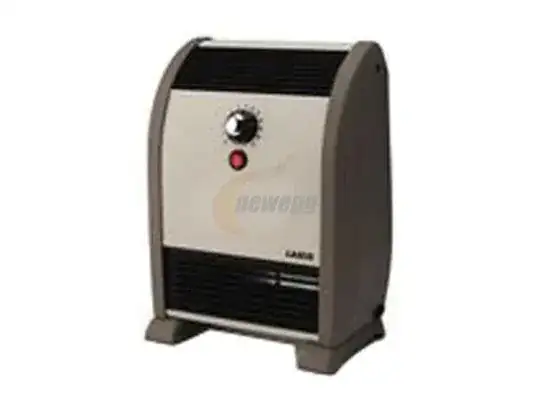

  • Use a 120Vac thermostat heater with a constant fan INSIDE your closed freezer set to 85'F or use a Honeywell thermostat rated for 120Vac with your hair dryer and wire up the heater but keep the internal fan circulating for homogenous air temp. enter image description here

  • I meant the 120Vac car heaters. The reason you dont use outside air is that it uses that air to regulate the heat flow and temperature. A hair dryer has no regulator. The reason for fans is in case the fan also shuts off or in case of fan failure. – Tony Stewart EE75 Nov 16 '12 at 17:01
  • Can you give me a link to the type of heater you're talking about? (I had planned on using any forced air heater within a closed-loop -- hair dryer puts out constant amount of watts of heat, but I didn't see the problem there, the thermostat shuts it on and off as needed, I suppose you're trying to design it so that the air put into the system is close to the desired final temperature and is on steadily, rather than being a high temperature and turning off and on thermostatically -- I can see how that's safer, but the thermostat could fail on either unit, its max element temp that matters). – birchbark Nov 16 '12 at 17:11
