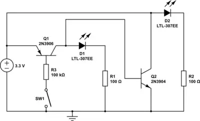

I have fairly little experience with circuit design, but after ~1 week of research, have come to the following design (see attached image). I would like to ask whether a few questions about this circuit:
(1) From the experienced eyes, would this circuit work (a) safely and reliably, and (b) achieve the intended switching behavior?
To explain this circuit:
-- Q3 is a p-channel power MOSFET; Q2 is a n-channel power MOSFET that drives Q3. (Otherwise, the 5V from Arduino cannot drive the 170V supply voltage).
-- R1 and R2 are a voltage divider to drop the voltage to ~165V when Q2 is turned on (when Arduino outputs 5V). This 5V difference turns Q3 on. (The limit on V_GS of Q3 is +/- 20V. So it seems necessary to have this voltage divider, instead of just throwing the full 170V on V_GS) The high resistance values were selected to keep the ON-state current low, because R2 drops ~165V and so the dissipated power could easily get above SMD resistor power ratings (~100 mW) even at a current of ~1 mA.
-- R3 is a pull-down resistor to ensure that the pin is never floating. I pick 10K (on-state current of 0.5 mA) for no strong reason; please suggest if other values could work better.
-- The output pin at the bottom is from HV57708, which connects to all 10 cathode pins from the Nixie tube. Typically, 9 out of the 10 would be set to 80V (an off-state, because even if the top-side switch is ON, 170V - 80V = 90V is not sufficient to ignite the tube), whereas 1 out of the 10 would be set to 0V (an on state; only applied to the cathode corresponding to the digit that we intend to glow).
-- Regard X as an open-circuit (nothing attached) for now.
(2) Would this high-side switch be able to support PWM-based brightness control, if the "Arduino output" pin is a PWM-compatible pin on Arduino?
(3) Let us now say that we want to completely avoid using PWM, which could have benefits, as some hypothesized that it reduces tube life. In such case, to achieve adjustments of the tube brightness, it seems like a plausible approach is to duplicate and mirror the entire Box 1, and place it at the location marked "X", again connected through R4. Under such scheme, the Arduino could control the number (and which) of the current-limiting resistors (R4's) that are in parallel.
More parallel resistors would increase the total current from the 170V source, thus brightening the tube -- correct? For example, with just 2 of these circuits, one with R4_A = 15K and one with R4_B = 30K, three different ON-state brightness levels could be produced. ( I = (170V-140V)/ R_equivalent, where R_equivalent is either 15K, 30K, or 1/(1/15+1/30) = 10K, leading to I = 3mA, 2mA or 1mA. This seems sufficient for my purpose. Would this type of stacking strategy work?
(4) If any expert have other solutions or insights on how to implement this tube brightness adjustment, I will be very curious to hear. (I initially thought about using a single digital potentiometer; i.e. 170V connects to R4, then to digi-POT, then to Nixie tube, then to HV57708 output. However, existing digi-POTs seems to have low current rating (~5 mA, which is about the current that needs to pass through) and low tolerated voltage drop (< 30 V).)
Circuit schematic
Hi fellow Nixie tube enthusiast, and welcome to this site!
Back a few years ago I was tinkering with a Nixie display myself and had the same problem as you; which I solved in essentially the same manner. I asked a question which contains the relevant part of the schematic. I'm using a PNP instead of the P-channel MOSFET though, I think it is a simpler and more rugged approach. Also, I can ascertain that it works (see it in action).
So, to answer your sub-questions:
  1. I would suggest the PNP variant in the linked question, and I know it works, from experience.
  2. Yes, you can use PWM to implement dimming.
  3. The several resistor taps idea might be interesting to pursue, but I feel it overcomplicates things, as it is based on the premise that PWM makes nixie tubes degrade quicker - this is just a hypothesis. I don't think it makes any difference on tube life, my nixie clock is 7 years old now and shows no signs of degradation.
  4. I don't want to brag and I'm certainly not an expert, but I would advise on to implement the PWM first, and see if you're happy with it.
In general - if you're a starter in electronics - go tinker! Start small, then build on top of it, and don't overcomplicate your first projects (on paper), because that way you may never finish them.
