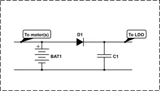

You must make sure that the motors do not drain your capacitor. Try adding a (Schottky) diode before the LDO and put the capacitor after the diode and before the LDO:

    I tried a Schottky diode (BAT85) and a cap(470u) in the configuration you suggested. Now no reset occurs when the motors spin till 50% duty cycle(PWM) but beyond it the controller resets. What may I do? Will increasing capacitance work? – Soham Mar 25 '20 at 06:57
  • You could try but you might have an inherent power problem. Meaning there may be no simple solution. – Oldfart Mar 25 '20 at 20:34
