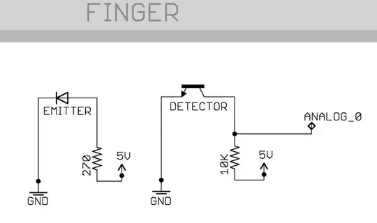

The input signal will be the output of a transimpedance amplifier, driven by a filtered photodiode. Signal-to-noise is expected to be pretty good, at least 30dBV.

Since the timer input is filtered, I'm thinking to eliminate the Schmitt buffer/inverter.
Also I'm wondering whether to use the STM32's internal comparators so I have a bit of extra fine tuning for edge thresholds and hysteresis, and connect the comparator output to the timer input, so that edge transitions on the comparator output drive clock inputs, allowing me to record precise timestamps of when edge-transitions occurred. I'd "tune" the thresholds by connecting DAC output to other comparator input.
Some STM32 parts have opamps built-in too, which I could maybe use for the transimpedance amplifier. The slew rate is only 0.7V/μs as far as I've seen, but that might be fast enough, I don't have a hard figure yet for what bandwidth I need.
Oh wait, the GaN STM32G-series parts have much faster opamps that are totally suitable for what I want to do!
