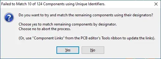

When I remove the J6 part, and I select: Project - Import Changes from Fuzz.PrjPcb, I get the following warning:
I select yes, and get:
I select Execute Changes, and Close. And I again see J6 without any net connections.
What should I change to be able to connect J6 to U1 (MCU) ?

    project->component links, any unmatched? – Spehro Pefhany Mar 19 '20 at 10:52
  • @SpehroPefhany Yes, that was the problem, see my answer (just added to help others with a similar problem). – Michel Keijzers Mar 19 '20 at 11:04
Problem is solved:
  • I removed J6 from the PCB
  • I Imported the parts again.
  • I Used Tools/Component Links to rematch the components again.
