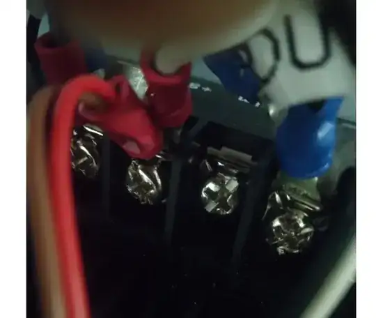

I have a DC-DC converter (24v to 12v) that has terminal block at its input and output terminal. To understand it better, I've attached the drawing of the converter found in its datasheet. DC-DC Converter drawing
Problem: This converter is used at work. And the existing configuration connected by others has multiple wires with fork connector end connected to each of the screw at output terminal.
Question is: Is it safe to be stuffing multiple wires with fork connector end into one screw terminal? And what is the understanding behind?

Actually my main concern is whether the 2 fork connectors (as in pic above) would result in a short circuit scenario when they are in contact with each other.
In effect you really want a short circuit. Both wires should have the minimum resistance to the terminals and since they are in close contact and screw clamped together the resistance between each other and the PSU terminal will be very low as in a "short-circuit".

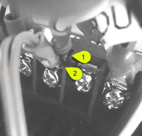

  1. Assume the case where 2 forks are not in contact with each other initially (because of the plastic protruding insulations just above the lugs as seen in the above pic, they prevent the screw to be screwed all the way in to keep the forks together).
That's not the situation. Look what the guys in forensics found after image enhancement:
Figure 3. The fork terminals have been correctly installed back to back to ensure full contact of the forks without straining due to interference of the crimp barrels. Fork (1) is installed "upside down" and fork (2) is installed "right-way-up".
Figure 4. Fork terminals are not symmetrical about the horizontal plane through the barrel centre. When installing two into one terminal it is advisable to mount them back to back.
And assume the forks are in contact with the screw in the terminal, so current will be drawn by each of the fork to their wires.
The whole terminal, fork, fork, screw arrangement is now one conducting mass of metal. All points should be at the same potential.
  1. Now, say because an accidental nudge to one of the wires (while the circuit is running), and then the 2 forks which are already carrying their respective current come in contact. Could this induce a short circuit?
No. If installed properly they are fully in contact already.
Could this be similar to how 2 live wires touch each other and cause a spark?
No. Two live wires1 touching each other won't cause a spark because they're both live and at the same voltage. You'll only get a spark when two wires of different voltages touch each other.
1Assuming that they're on the same phase of the supply.
