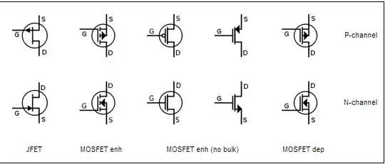

This Wikipedia page is confusing me: http://en.wikipedia.org/wiki/MOSFET
Image that's confusing me
The above image confuses me. For the N-channel, it shows the diode's polarity going towards source in some, but away from the source in others.

When a channel exists in a MOSFET, current can flow from drain to source or from source to drain - it's a function of how the device is connected in the circuit. The conduction channel has no intrinsic polarity - it's kind of like a resistor in that regard.
The intrinsic body diode inside the MOSFET is in parallel with the conduction channel, however. When the conduction channel is present, the diode is shunted and current flows through the path of least resistance (the channel). When the channel is off, the diode is in circuit and will either conduct or block depending on the drain-source current polarity.
As your picture shows, there are both N-channel and P-channel devices, as well as enhancement mode and depletion mode devices. In all of these cases, current can flow from source to drain as well as from drain to source - it's just a matter of how the device is connected in the circuit.
Your picture does not show the intrinsic diode in the devices - the arrow point towards or away from the gate is an indication of the channel type (N-channel points towards the gate, P-channel points away from the gate).

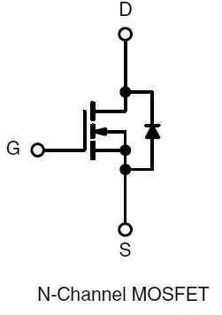

n-channel enhancement MOSFET
This symbol shows you the inherent diode between drain and source.

Conventional current flows from Drain to Source in an N Channel MOSFET.
The arrow shows body diode direction in a MOSFET with a parasitic diode between source and drain via the substrate. This diode is missing in silicon on sapphire.
2a is a JFet so different topology.
2d is a MOSFET with no body diode. I've never seen one.
2e is a depletion mode FET - it is on with no gate voltage and takes negative voltage to turn the FET off. So the diode has the other polarity, otherwise the body diode would conduct whenever there was gate voltage.

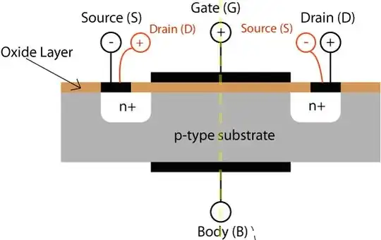

Yes, the current can flow from drain to source and vice-versa. To simplify it even further, I would like to add a bit to just what @Adam Lawrence has mentioned.
I am sure you are familiar with the cross section of the CMOS transistor. You can see that the cross section of the Mosfet is EVEN from the center vertical line. So, whichever (out of the two terminals on sides of nmos) terminal has higher voltage than the other terminal, that becomes your drain (for NMOS) and the other terminal with lower voltage becomes the source (for nmos). The reverse is followed for pmos.
Nevertheless, be careful when buying/dealing with discrete 3 pin Mosfets (i.e SiHG47N60EF) where internal bulk is already connected to the source(for nmos) or to the drain (for pmos) internally. This makes the mosfet pins predefine as mentioned in the datasheet. In that case, the above is still true that higher voltage terminal is drain and lower voltage terminal is source for nmos. However, if you apply higher voltage to the predefined source as mentioned in the datasheet, the threshold voltages will not be same as mentioned in datasheet. And your transistor will not behave as same as what is specified in the datasheet.

    But this switching based on voltage wouldn't work in most actual transistors because they are diodic, right? – PitaJ Sep 16 '15 at 23:11
    Yes they are. Those diodic mosfets are referred to as reverse body diode which have slightly different structure from the one above and you are right, they won't work if you swap drain and source pins. The picture above depicts the mosfet usually referred to in an integrated chip i.e VLSI designs. – dr3patel Sep 16 '15 at 23:51
