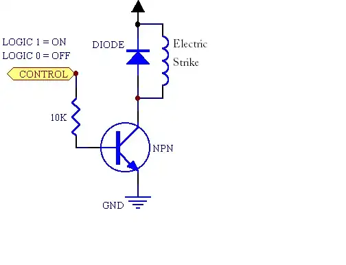

To be clear, what you posted is a wiring diagram, not a schematic. A schematic of your circuit would look something like this:
Would a 2N3904 NPN transistor and a 1kΩ resistor work together in this scenario
1kΩ is probably fine. We don't know the peak and holding current for your magnetic strike (they rarely publish such information from my experience). The 2N3904 is rated for 200mA, likely not enough for your strike. I'd guess that the strike will take around 1A at 12V, so you may want to use a relay to handle the current. For that, you can use your 2N3904, just use it to drive the relay coil (5V, powered from your Arduino, or 12V, powered from your external supply), and use the relay to control the strike. This discussion may be helpful.
What would happen on the Arduino if you had more than two wires that needed to be grounded
It's not quite clear what you're asking. The Arduino doesn't care how many ground wires are attached (they'll all be at the same electrical potential, or 0V). What the Arduino may care about is how much current needs to flow into its ground pins. As long as you're not passing the current from the strike through the arduino board, you should be fine.
Is the diagram that I have suitable for the strike, or am I missing anything.
Note the flyback diode in the schematic. Even if you go with the approach of using a transistor to drive a relay and using the relay contacts to power the strike, you'll want a flyback diode across both the relay coil and across the strike itself.
The strike is basically a big inductor - once current starts flowing, it wants to keep flowing. Most strikes have a MOV snubber integral with them to suppress spikes, but a reverse-biased diode will do a better job of eliminating transients. A lot of strikes are made to work on either AC or DC; a MOV works for both, but the reverse-biased diode can only be used when applying DC.
The power supply I linked to.
Should be fine, based on the limited information we have. If the strike needs 2A or less, it should work.
Can you tell if it has two wires or one?
Assuming that you're referring to the strike, I'd guess that it will have two wires, but there's only a couple ways to tell for sure: Ask the reseller or order one.
why do strikes such as this one have 4 wires, instead of 2
So they can be used in either 12V or 24V applications. For 12V, connect the two coils in parallel; for 24V they're connected in series. There should be a (sometimes very small) datasheet that comes with the strike that has connection instructions.

  • Thanks for the info. As for the schematic, sorry about that. Fritzing has the option to output a shchematic (I believe), would I be better off outputting that from now on if I need advice? Also, is the diagram that I have suitable for the strike, or am I missing anything. The power supply I linked to. Can you tell if it has two wires or one? – Charlie Nov 08 '12 at 14:10
  • Schematics are more design-centric, while wiring diagrams are more assembly-centric. I'd post the format that best suits the question you are asking. I've edited the answer with the other answers to your questions. – HikeOnPast Nov 08 '12 at 17:45
  • **Okay**, I redrew the schematic: http://i.imgur.com/tChKv.png Is this correct, using the diode in the correct place? The only thing I couldn't figure out from the schematic you posted was the location of the power supply, so I assumed where it was. **And** when I was talking about the two wires, I was talking about the DC power adapter. wondering if it had a negative and positive wire, which I should've realized it does. **Also**, why do strikes such as this one have 4 wires, instead of 2: bitly.com/VJOWGQ – Charlie Nov 09 '12 at 01:00
  • @Charlie, you've got it drawn perfectly...if you're going to use a high current transistor. I still recommend using the transistor to drive a relay, and using the relay to drive the strike. I've added the answer to about the strike, above. – HikeOnPast Nov 09 '12 at 03:19
  • Awesome! "I still recommend using the transistor to drive a relay, and using the relay to drive the strike" could you provide a schematic of what you mean here? Also, how do I know which wire from the DC wall supply, the negative and positive, goes to either the diode or the transistor? – Charlie Nov 09 '12 at 03:25
  • See edits, above. – HikeOnPast Nov 09 '12 at 04:44
  • Okay, is this correct? http://i.imgur.com/GpVm0.png – Charlie Nov 09 '12 at 22:13
  • Not quite. Compare the relay contacts in your design to what I posted earlier. Trace the flow of current from the power adapter to the strike. How will this ever turn off? – HikeOnPast Nov 09 '12 at 22:43
