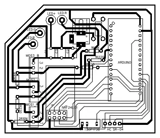

First time hobbyist here. Is it a common issue for closely placed track lines to end up touching each other during the toner transfer process (I'm assuming this is the correct term)? If so, are there any quick fixes I can do to my process to fix it? I'm just trying to avoid redesigning the PCB layout (unless that's the only option).
Please see attached pics -PCB board PCB layout design Yes some of the tracks are too close, but what I don't get is this - when I print it on paper, the lines are thin and the gap is reasonable. But when I use nail polish remover and place the paper on the copper board, at least 1-2 lines end up getting closer or nearly touching - see area marked in blue, bottom left. Track width is 0.25mm and gap is 0.5mm which I would think is reasonable. In the first two iterations I tried, these lines didn't end up touching, it was other lines. Is there anything I can try aside from redesigning the layout?
The process I'm following: I printed the layout on glossy paper on a laser printer. Cleaned the copper board and poured a really small amount of nail polish remover on it. Spread it evenly. Placed the layout paper on the wet surface and gave it about 5 seconds. Then using a paper towel, applied vertical pressure (not horizontal) for about 30-50 seconds. Then took the paper towel away and waited for the thing to settle for another 2 minutes. Finally dunked the board in water for another 2 minutes and tried peeling the paper. The toner transferred better than my previous attempts where I didn't give the process any time and also applied horizontal pressure/swipes.

  2. Two track lines at the bottom ended up touching each other. Yes I accidentally scratched them later, but they were reasonably apart pre transfer, but touching aftewards. Is there a way to prevent this from happening? does it just take practice?

The toner "melts" a little when using the toner transfer method. You need to place your traces a little bit further apart.
Traces can also slide around a little. When you've got the whole thing soaked in acetone, all that is holding things in place is the liquid. When you go to soak it in water, it is very easy to accidentally wiggle the paper and smear your traces.
It takes some practice, and you need to allow more space on the board to get it to work out right.
