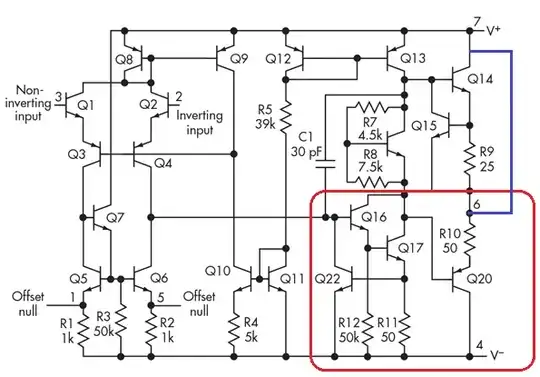

I have completed my answer to the question about the Widlar's limiting circuit but there is something unclear to me - how the transistor Q22 manages to limit the load current when the output is short-connected (in blue) to V+ or ground.
The usual explanation is that Q20 base current, entering Q17 and flowing through R11, increases sharply. As a result, the voltage drop across R11 increases as well, Q22 begins conducting and fixes Q16 base voltage.
But how is it possible somehow to change Q17 collector current while its base voltage is kept constant? Q17, like any BJT, behaves as a constant current source (sink here); so its collector current cannot be changed from the side of the collector... the voltage drop across R11 cannot be changed as well...
I have some explanation... but if it is true, I will not like this circuit solution so much... because it would not be valid in any case...

  • *But how is it possible somehow to change Q17 collector current while its base voltage is kept constant?* - it isn't kept constant, Q22 reduces Q16's base voltage and that in turn reduces Q17's base voltage in order to "roughly" maintain a constant current through R11 (in turn that maintains approximately the same current into Q20's base). – Andy aka Feb 29 '20 at 17:53
  • Q14, Q15 and R9 form a current limiter. For example , if the output is shorted to ground, the output current will be kept at Vbe/R9. – Rohat Kılıç Feb 29 '20 at 17:56
  • @Rohat Kılıç, I mean to consider the behavior of the lower current limiter (Q16, Q17 and Q22) when the op-amp output is short-connected to V+. – Circuit fantasist Feb 29 '20 at 18:15
  • @Andy aka, Imagine, in the beginning, we have set some constant input voltage so that Q16 base voltage is constant. Then we connect a variable load resistor (rheostat) between the output and V+. There is some (small) Q20 base current that, together with Q13 quiescent collector current, enters Q17 collector. Both they flow through R11 and create a voltage drop that is unsufficient to turn on Q22. Then we begin decreasing RL up to zero (short to V+). Q20 base current increases... but Q17 (behaving as a current sink) shouldn't let it do that. So the voltage drop shouldn't change. – Circuit fantasist Feb 29 '20 at 18:30
  • Circuit fantasist, You are right that the negative side of a current protection circuit won't work as efficiently as a positive side will do ( hard current limiting Vbe15/R9 = 30mA). Maybe this is why there is another version of this circuit https://www.righto.com/2015/10/inside-ubiquitous-741-op-amp-circuits.html used by Fairchild https://datasheet.octopart.com/LM741CN.-Fairchild-datasheet-7561151.pdf – G36 Feb 29 '20 at 19:31
  • @G36, Exactly! I often come across this more beautiful symmetrical version and wonder why it is not considered in textbooks as more comprehensible. Now we just have to explain how the worse version still works... and when it would not work at all. Of course, this is not so significant today, 50 years after its creation. But the benefit of this is to show ways to understand things that are hard to understand or kept in silence. Your link is very interesting. Thanks for the support, I need it in such an endeavor... – Circuit fantasist Feb 29 '20 at 20:30
