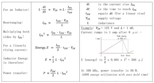

Formulas used
Inductor energy (W) equation: - $$W = \dfrac{L\cdot I^2}{2} \Longrightarrow I = \sqrt{\dfrac{2\cdot W}{L}}$$
