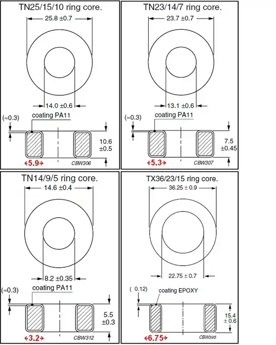

Maybe this can be answered by examining four popular\$^1\$ ferrite toroids from Ferroxcube. In fact these toroids are not square cross section but rectangular; the smaller dimension producing even less discrepancy between the inner and outer radius (in red is my calculated dimension): -
The same was also found for Fair-rite toroids. In other words, the preference is to have a rectangular cross section and that naturally means an even longer winding length than a square section and, an even longer winding length than a circular cross section. This is highly likely to be because it is the magnetic part of any transformer or inductor that is potentially more lossy compared to \$I^2R\$ Cu losses.
So, we usually take the mean effective path-length as that passing through the core mid-radius (i.e. where the middle of the jam is in a doughnut) and, ignore the truth that the inner radius will be slightly more prone to saturation than the outer. That’s what we do as engineers but, if we’re being picky about our design, we would need to consider it.
A circular cross section core will naturally have a smaller inner radius and, because of this, it will tend to magnetically saturate a little bit more at that inner radius (compared to a square cross section) and even more so when compared to a rectangular cross section toroid core.
