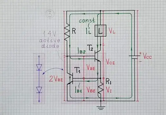

And here is the brilliant Widlar's idea - to use the existing T2 base-emitter junction as the diode network needed (Fig. 3)! So we can consider the interconnected transistors T1 and T2 as an active diode with emitter follower in the feedback network. This is the "devilish" Widlar's trick here... What is the main advantage of this solution?
Fig. 3
Fig. 3. In the ingenious Widlar's circuit, the transistor is driven by a reference "active diode" T1 with voltage 2VBE
The "forward voltage drop" of this "compound diode" is adaptive (self-adjusting). In this case, it is 2VBE = 1.4 V. But if we replace T2 with a Darlington transistor (e.g., Q16-Q17 in the top picture), T1 will "lift" its collector voltage with another 0.7 V and it will become 3VBE = 2.1 V. So 1.4 V of them will drop across the both base-emitter junctions of Darlington transistor... and the same voltage VBE = 0.7 V as before will be applied across RI.
For the curious: It is interesting that here the base-emitter junction is driven in a differential manner both by the side of the emitter and base. For example, if the load current increases, the emitter voltage increases while the base voltage decreases.

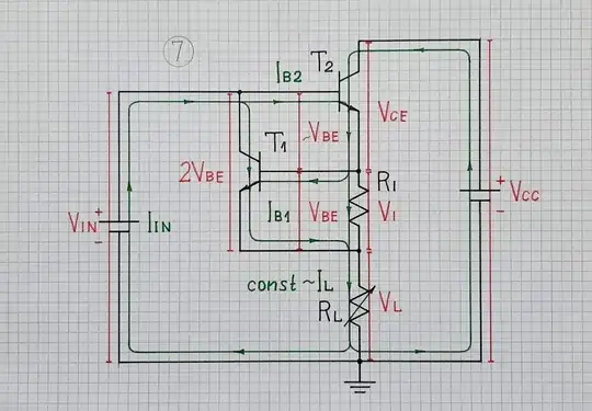

5. Limiting on. When the load current IL exceeds the current threshold (Fig. 7), the voltage drop across RI reaches the threshold of 0.7 V. The situation is as in Fig. 3 above. The transistor T1 begins conducting and the negative feedback comes into picture. T2 acts again as an emitter follower... but now it is driven by the small constant (reference) voltage VREF = 2VBE... and it keeps the small constant VBE = 0.7 V across the constant RI. As a result, the current IL through load is constant... the varying voltage source (emitter follower T2) from above is transformed into a constant current source with fixed current... and T2 is protected from damage.
Now look at the IIN current loop (in green) and imagine the load is a short connection. There is no any resistance in the loop; the current IIN will be unlimited... and T1 can be damaged. T1 protects T2... but "dies"... So the input voltage source has to be imperfect... having some internal resistance.
Fig. 7
Fig. 7. When the current limiting is on, T2 acts as a constant current source driven by the reference active diode T1 with voltage 2VBE
The current loops (in green) will help you to imagine the circuit operation in this mode. They are drawn according to the principle that each current returns to where it started from.

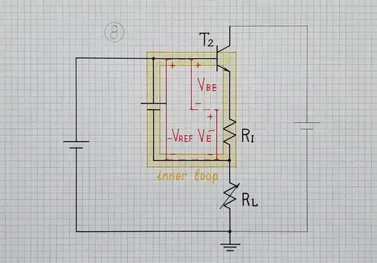

At the end of this story, let's see how the negative feedback principle is implemented in this voltage source acting as a current source - Fig. 8. As you can see, it is equivalent to Fig. 4. In both figures, the voltage VE across RI and the input reference voltage VREF = 2VBE are subtracted in a series manner (KVL) in the same input loop (in yellow); the result is applied to T2 base-emitter junction. The only difference is that the subtracting loop in Fig. 4 is grounded while in Fig. 8 it is floating.
Fig. 8
Fig. 8. In the constant current source T2, the emitter voltage across RI is subtracted from the reference voltage VREF = 2VBE in the inner subtracting loop (in yellow)
