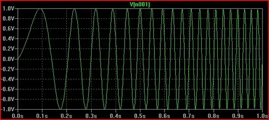

I have an Agilent 4980 LCR meter and in its manual it has several graphs indicating the effective measurement ranges for each scale, like the one below:
How to read such a graph to be sure that the instrument can effectively measure my device's characteristics? For example, if I have a 500 uF capacitor with an ESR in the range of 0.2 mOhm and ESL 10 nH, how to check these values in such graph?
